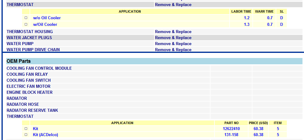

Replacing the thermostat tomorrow, how annoying is it to locate and access?

I thought this was going to be a problem right off, when the thermostat housing could not be located.
Old Jan 27, 2018 | 06:53 PM
Posts: 40,087
Mine is easy to see, once you remove the air filter box.

Thanks to everyone who replied. I got the after-market thermostat in just fine, burped it for a while, drove around and let it burp itself, topping off as needed. Everything is swell now. On the highway I range between 189-192, in town just a couple degrees higher, and at a light or any other full stop, no higher than 205. Everything is back how it used to be.
As for the critical comments on my choice of parts, I understand the ACD part is a much more permanent solution. I DIDNT realize that when I purchased what I did. I appreciate the concern, but not so much the occasional snide tone I was getting.
As I said, now that I've done it once- if I suffer the consequences of getting the less durable part in a few years- it's a relatively easy fix I can do myself. The car is an 06 that I got in 2014 with 30k on it. Now it's at 63700, and this is just happening with what God can only assume was the original t-stat. I'll probably be alright for a while.
And to whopper, it's not that I flat out ignored the advice. I had already purchased the aftermarket part when I made the post. I work weekdays, and the weather has been generally crap where I live, as per the season. Today, it was 50° and cloudy, the best chance I had to do the job anytime soon. I couldn't just return the part and get the right one off Amazon and do it next week (for several reasons). Like I said I appreciate the concern, it just wasn't possible for me at this time.
Again, thank you for the replies.
