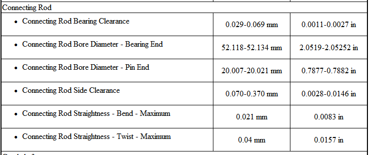

I have a HHR with the 2.2L Ecotec with ~130,000 miles. I have found I spun at least 1 rod bearing (may or may not be from inadvertent oil starvation). After ordering a standard set of rod bearings and Plastigauging the clearances, I find I need undersized bearings. The problem is, my Plastigauge came out to 0.102 in.
By my math, if I place a pair of 0.030 shells in, my clearance will become 0.036, minus the 0.0011-0.0027 shows I still have 0.0349-0.0333 to go.
Is this too great of a clearance?

This is all I could find, hope it helps.
2007 2.2L
