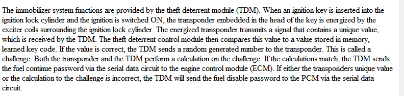

The anti-theft module is that odd thing that wraps around the key cylinder with wires running down the column. #1 in this pic.

The challenge/response stuff is between the key and the module. The BCM just does what the TDM tells it to do.
Fuse #10 on the BCM provides power to the TDM.
I suspect there is a loose/damaged wire in this case.
