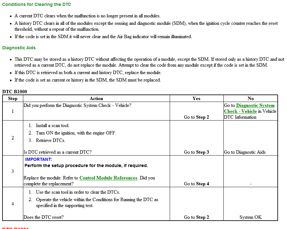

This is what Mitchell says about B1000:
You may need a new SDM, you will need a expensive scantool (Tech2 or equivalent) to program and match the new SDM.

See post #5, it explains. The codes should be the same for a 2010, but that does not really matter. The codes are "generic" the meaning applies to all cars built since 1996.
B1000-00 means you SDM needs to be replaced if the code is set in it, not just in the ECM. You have the code, no more agonizing needed, except for which type the code is; current, stored, historic.
