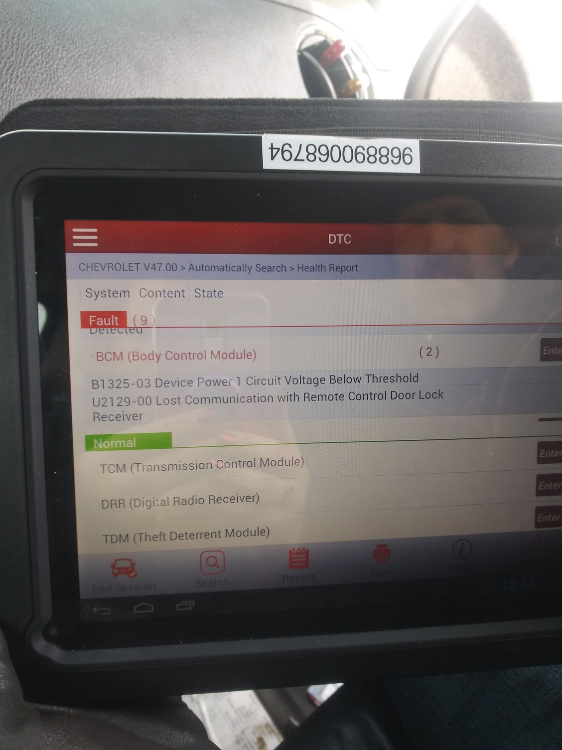

Okay so my 2008 HHR LT is doing the same thing but my car will only start with a jump. And dies a few seconds after started.. I have put in a new battery and a new alternator. I have also cleaned and reseated all fuses in fuse box under hood and also on the BCM. Tonight i replaced the main fuse to the BCM (by the battery) the new fuse is a little different then the old one. Not sure that matters. But its still not working. Scanned and got a code for BCM. But still not sure. Any ideas????

Sorry, B1325-03 Device Power 1 circuit voltage below threshold

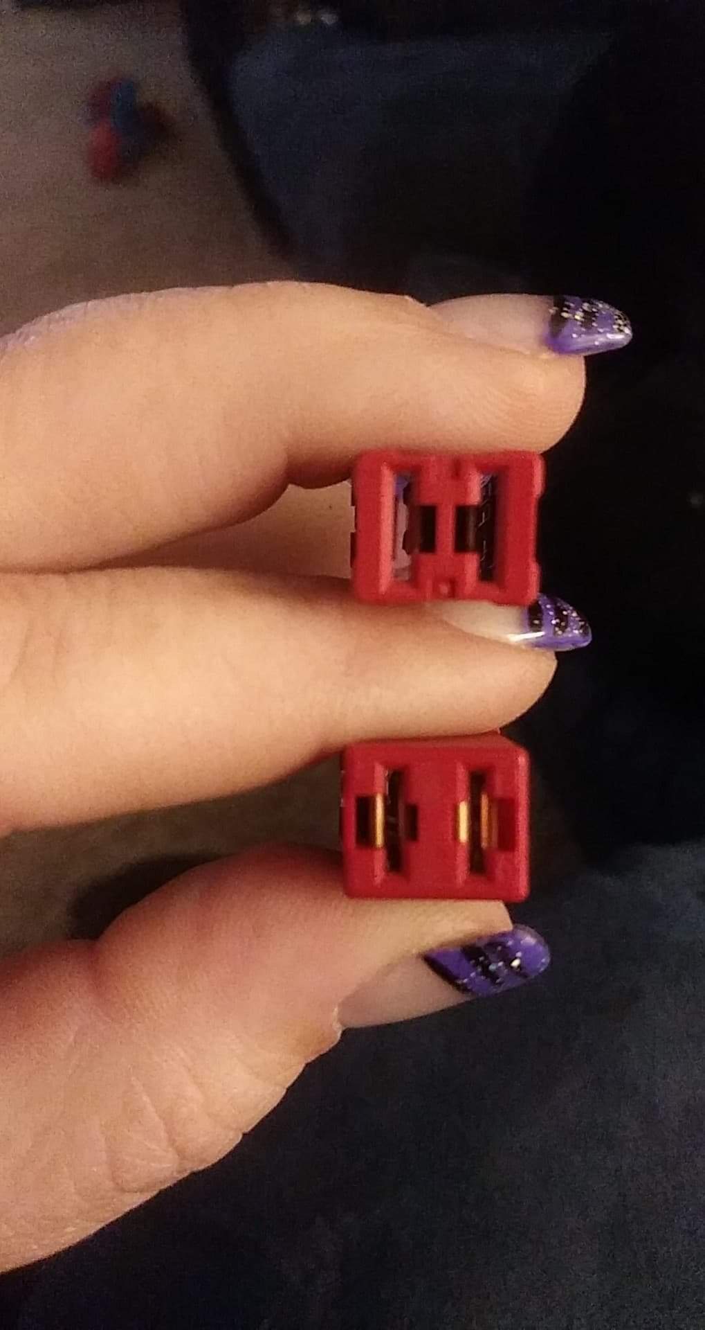

I was told that the BCM main fuse is by tne battery so i went amd got a new one. But the new one is a little different then the old one. Not sure that matters..but didnt change anything. Still will only start with a jump and will only stay running for about 30 seconds with all the dash amd radio lights flashing on and off and the wsx service tracking esc off power steering livhts bells amd whistles come on ans car dies again i just cant figure out the issue. Maybe needs a whole new BCM?? Bottom fuse is the old one top is new

It doesn't mean what you think it means. It means that one or more of these modules is getting less than 9 volts: BCM, Instrument panel, radio or The SDM.
So, first step is to ask what is not working? Does the radio work? Does the instrument panel work? Does the airbag system work?
My first guess would be fuse #13 on the BCM.
The U2129 means the RCDLR is without power or the data line is broken. That would be fuse #23 on the BCM.
Check the fuses with a meter not your eyes.
Check for power to each of the modules, The SDM is under the console behind the shifter.

Do the remote door locks work / the TPMS? The passenger airbag light should tell you something.
When the code sets the run/crank relay shuts the car down after 5 seconds. So that is expected. What was going on just before this behavior started.
