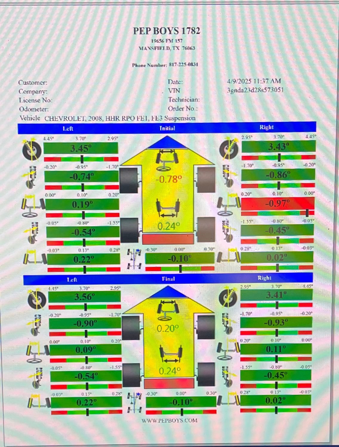

I recently changed rotors, brake pads, replaced LCA from another HHR that I put new TRW ball joints with 12mm bolts and rear bushings, outer tie rod ends, sway bar links and struts. I did a close alignment with a tape measure, but it still pulled to the left a little. I took it to pepboys to have it aligned. The mechanic said he had to swap wheels, front left and front right to keep it from pulling. The tires are both worn slightly on the inside edge. Wheel bearings are original (140K).

Smooth inside wear is from bad toe out. If it is lumpy it is bad bearings. Adjusting the toe affects the camber and caster. Toe is the only available adjustment.

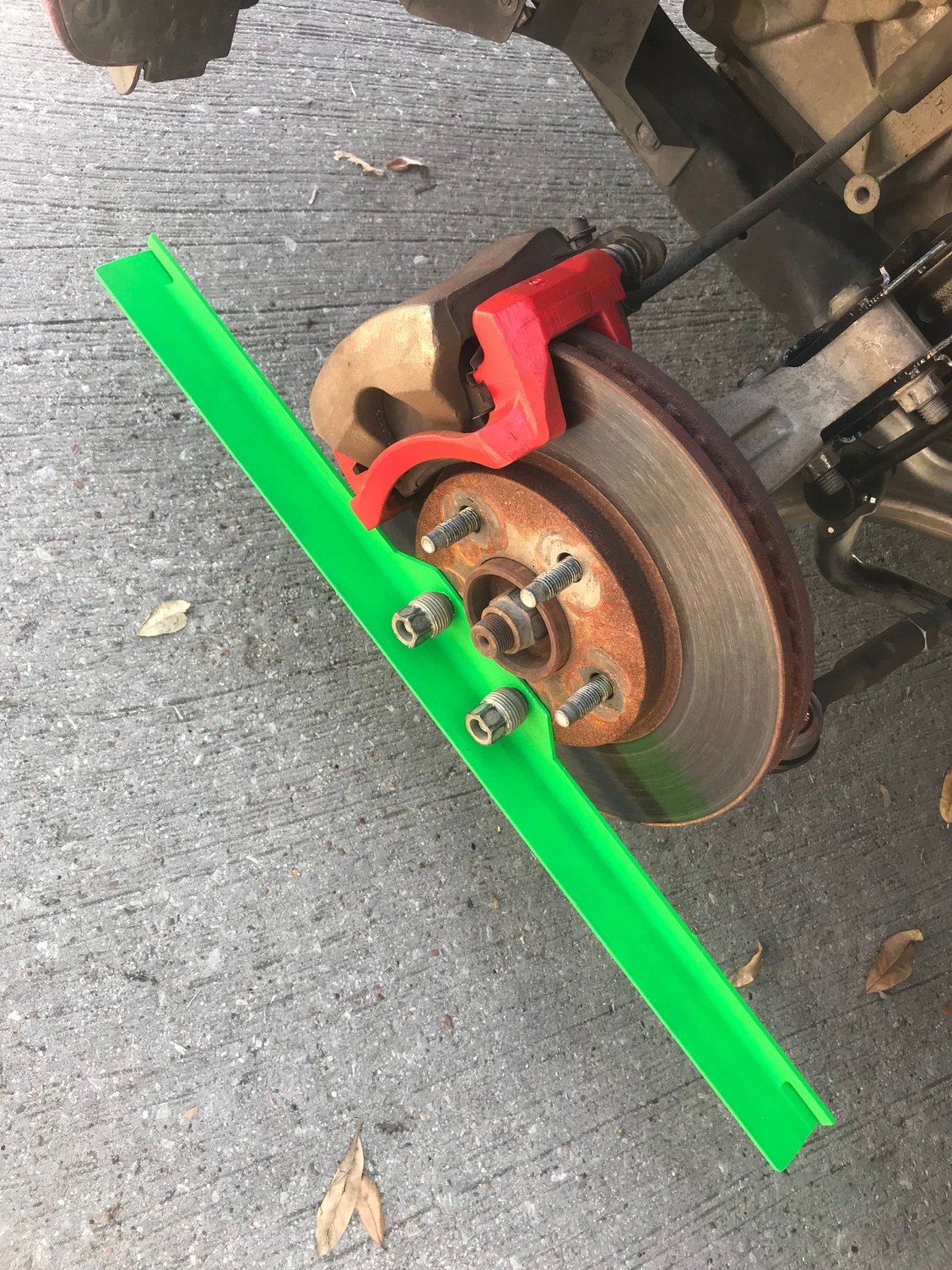

Swapped front tires to back and runs sooo much smoother. This is my hillbilly alignment tool that I made out of 1-1/2 angle iron. It gets it in the ball park. I like the fact that I can press on each side very hard to find movement within the suspension parts. My HHR and me have a love hate relationship. I hate working on them, but I learn so much about it thanks to this forum and YouTube. Thanks guys.

So tires are your main issue, run them for now then replace all four maybe next spring!
as for the alignment tool you made there are loads of them on Temu, EBay and Amazon.
problem is the LCA doesn’t push up on the suspension for an accurate alignment.
