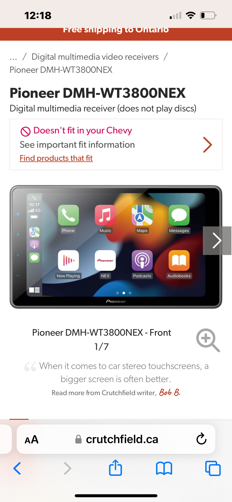

I have a 2008 HHR SS with a 6-CD Changer radio system. Occasionally, more often than not, when listening to the radio or one of the CDs, the system will go off and give an error about auxiliary input. Sometimes turning the radio off and back on it'll work again sometimes not with the same error. A local stereo specialty shop says nobody works on them anymore and wants to sell me a unit for, installed, for just over $800.
Looking around for a replacement I found a Pioneer DMH-WT3800 unit with a touchscreen display and Apple Carplay. Since I have the songs from the CDs on my Apple iPhone I'm not losing any music capability and gaining the capabilities of my major iPhone apps. This unit I can get for $700.installed through Best Buy. Does this sound like a good replacement? Any other suggestions?

I checked the Crutchfield site the DMH-WT3800 does not fit your SS

Check these models that fit your HHR SS
https://www.crutchfield.ca/g_473950/...Receivers.html
