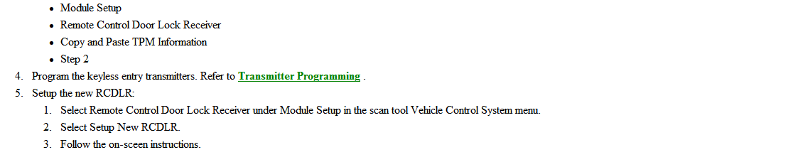

To begin the software update is for 2008 models.
Then, the new RCDLR needs to have it's software loaded.

I made my way through the wall of words, he did relearn. The positions are set, the BCM doesn't know what language the RCDLR is speaking. New RCDLR don't have the software loaded.

I wasn’t sure , till Don pointed the reprogramming of the new part.

Ok, that confirmed my theory.
a new flash is required
