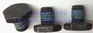

Rattle at start up like a tensioner, or worse.
After inspecting the chain and tensioner, all looked good and tight.
Turns out that the recent transmission rebuild and new torque converter we culprits.
The torque converter bolts had come loose...SURPRIZE

What used the old bolts with no Loctite ? New bolts are dipped in Locite
Here's a chart for the torque specs
GM 2.2L-134ci-S4 Torque Specifications - TorkSpec - Knowledge for the Motorhead

guess the repair shop didnt have a torque wrench handy....or any locktite....

Lol...just try and get a torque wrench in there! Loctite helps for sure. I haven't replaced my bolts, both engines have not given me any trouble.
