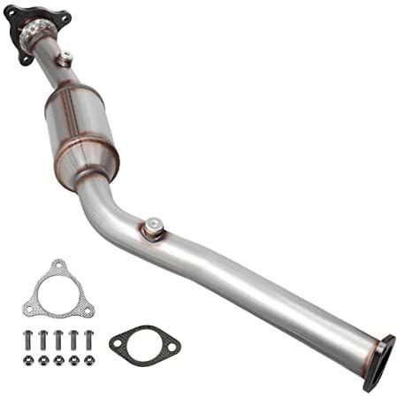

Yes a hole in the flex pipe , there are replacement pieces
Weld or clamp on flex pipe
Or this mandrel bent down pipe will wake up a 2.2 or a 2.4
https://mufflerexpress.com/products/...rter-2005-2007

So while I was napping before work, my got under my car to find out what was causing the exhaust noise. He said he was checking all my wiring, sensors, etc as well. He was tightening up bolts here and there. He got to the flange gasket and he said the gasket exploded and hit him in the eye when he tightened it. His eye was swollen pretty good. Now don't ask why he wasn't wearing safety glasses...it's like asking me why I wasn't wearing gloves. He is way more stubborn than me.
Anyway...can a new flange gasket be easily replaced? He mentioned something about a part was welded and wasn't confident in tackling the repair. But later said he would try to fix it if I wanted him to try.
Old Mar 8, 2021 | 08:22 AM
Posts: 26,533
Pretty sure he is referring to the aforementioned flex pipe. Welding is probably needed.
Old Mar 8, 2021 | 10:30 AM
Posts: 40,083
Yes, which flange the 3 holed one at the exhaust manifold or the 2 holed one at after the catalytic converter, before the resonator

I'm pretty sure it's the three bolts gasket. I have texted him to confirm...but it could take all day to get a reply.
