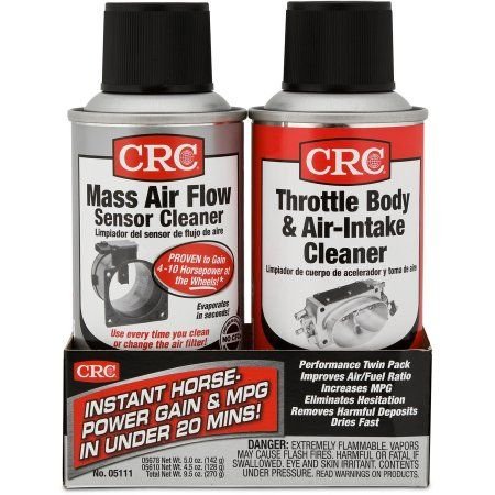

Originally Posted by Oldblue
I’ve been running an oiled air filter for a few years, the trick is , don’t over oil it!
Clean the MAF with a quality cleaner specific to it, like CRC
Just found a fantastic deal on Amazon for that 2-in-1 pack!
https://smile.amazon.com/CRC-Throttl...70_&dpSrc=srch
Whoops! Only a deal if you can wait that long. Don't understand why shipping is so long even though sold by Amazon.
