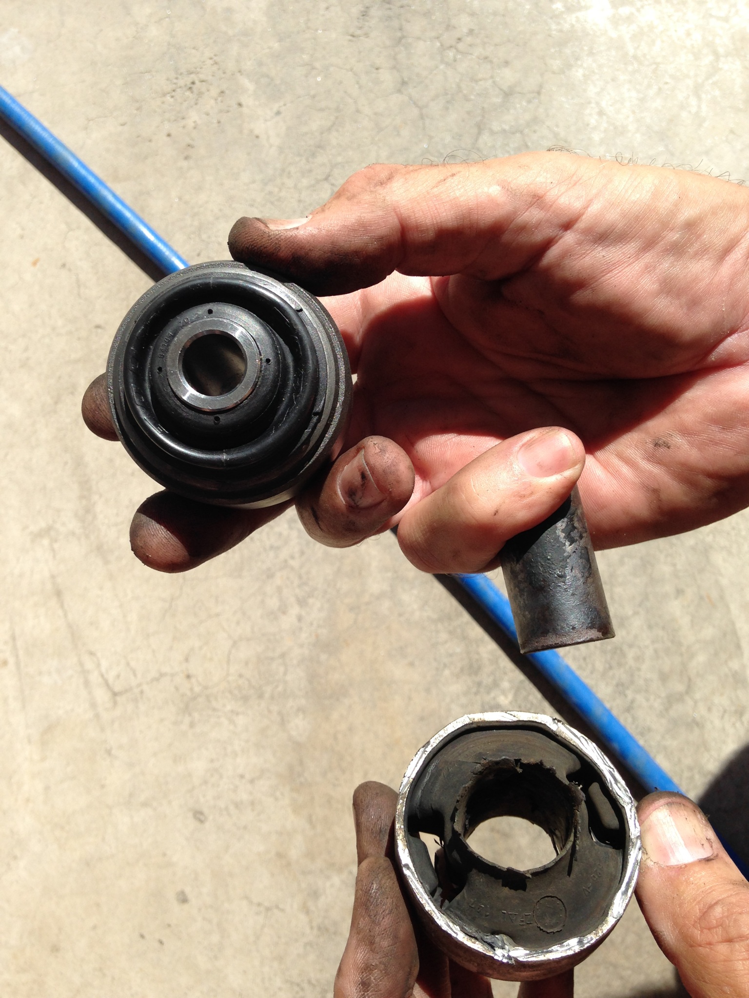

Posts: 39,986
Nope it's a caliper hanging up or the afore mentioned LCA rear bushings!! The one on the right was supposed to have been just fine!! Now that being said, also double check your ball joints and inner and outer tie rod ends! Just to be sure!
