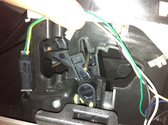

Unfortunately, driving my wife's Suburban isn't a viable option as far as gas prices. So I caved and picked up the standard automatic shifter assembly. I got the e-mail from GMPD as I pulled into the dealership. During the teardown of my HHR (the car is messy, I have a 4 year old), I found this:
Yeah. I'm more than a little angry that GM hasn't issued a recall for this. 21,903 miles on the car. This shouldn't happen.
