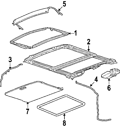

Not sure if this will help or not.

Posts: 39,988
Looks like the motor is at the back end of the frame

That does help are there any descriptions on parts 1-8? I can pick out half of them. In wondering if 1 is the frame and 2 is the window itself. From the pic it looks like the moving parts(+tracks to clean) are part of #1.
