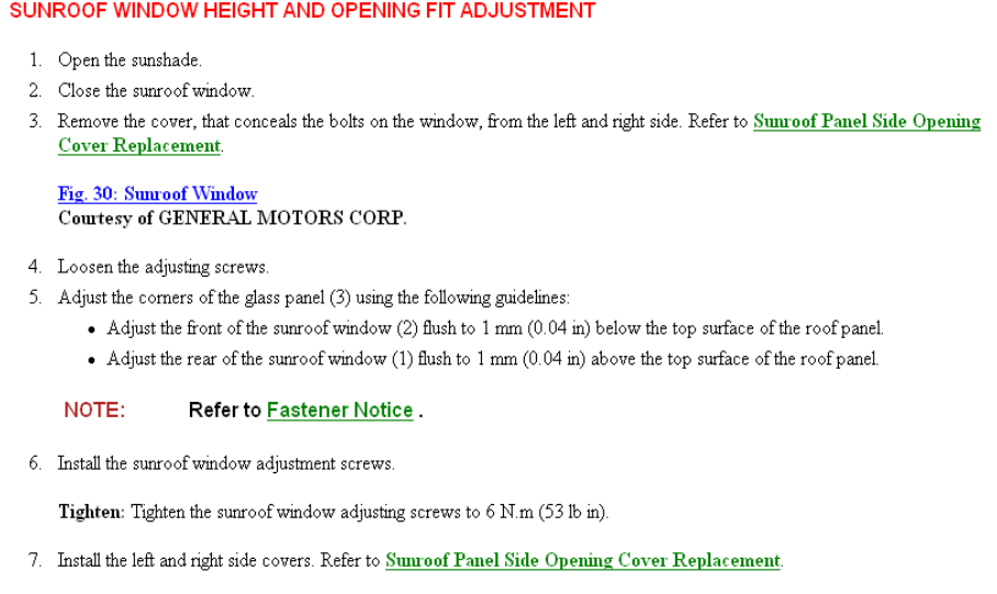

Here are 2 snippets from the shop manual that might help:
