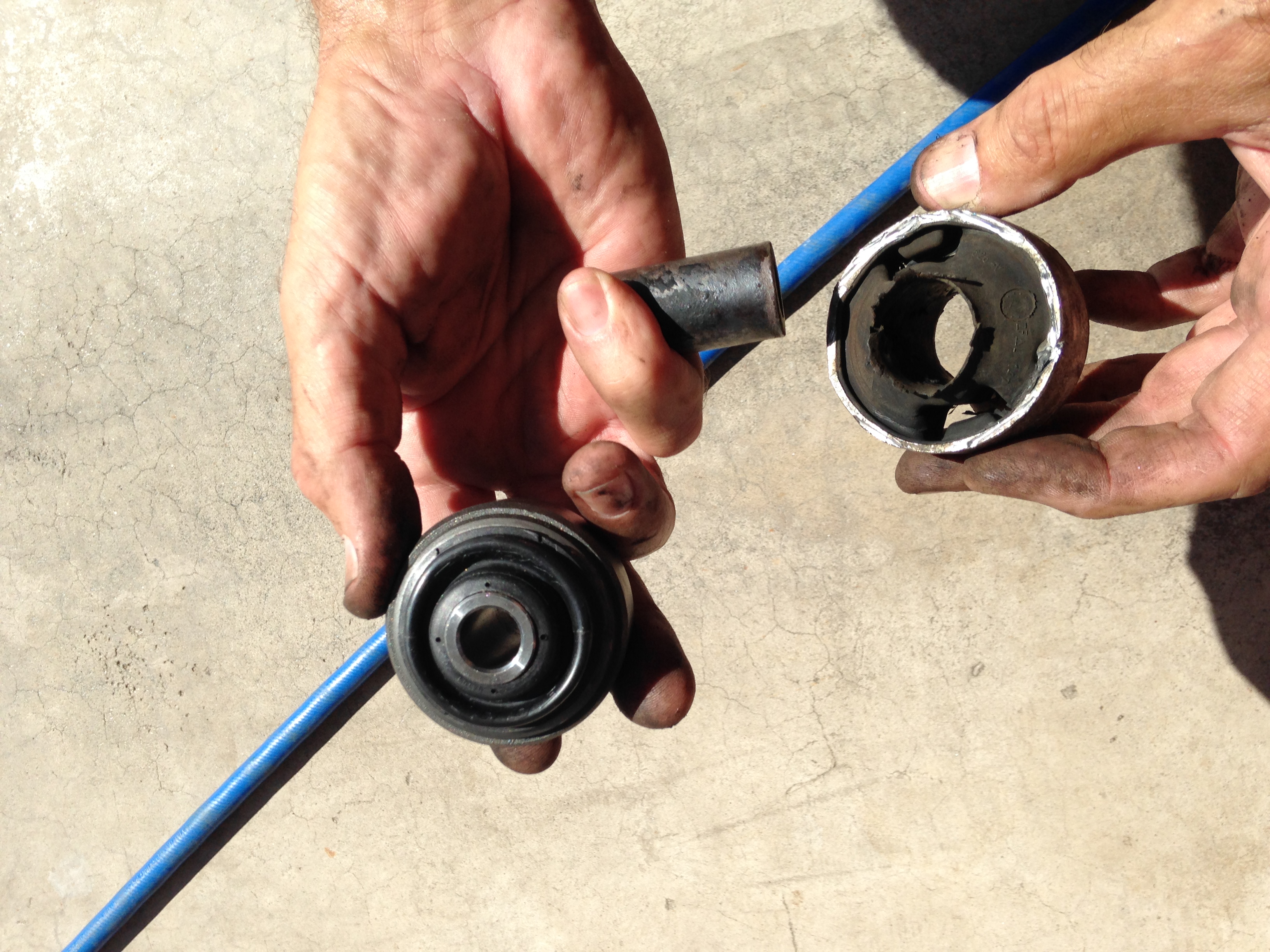

If your lower control arm bushings go south, you will need two of these to replace to soft and mushy rubber bushings
MOOG-K200792 - Front Lower Control Arm Bushing - Rear Arm to Frame made by MOOG
Second best improvement on the HHR, the larger SS brake upgrade was the 1st!!
