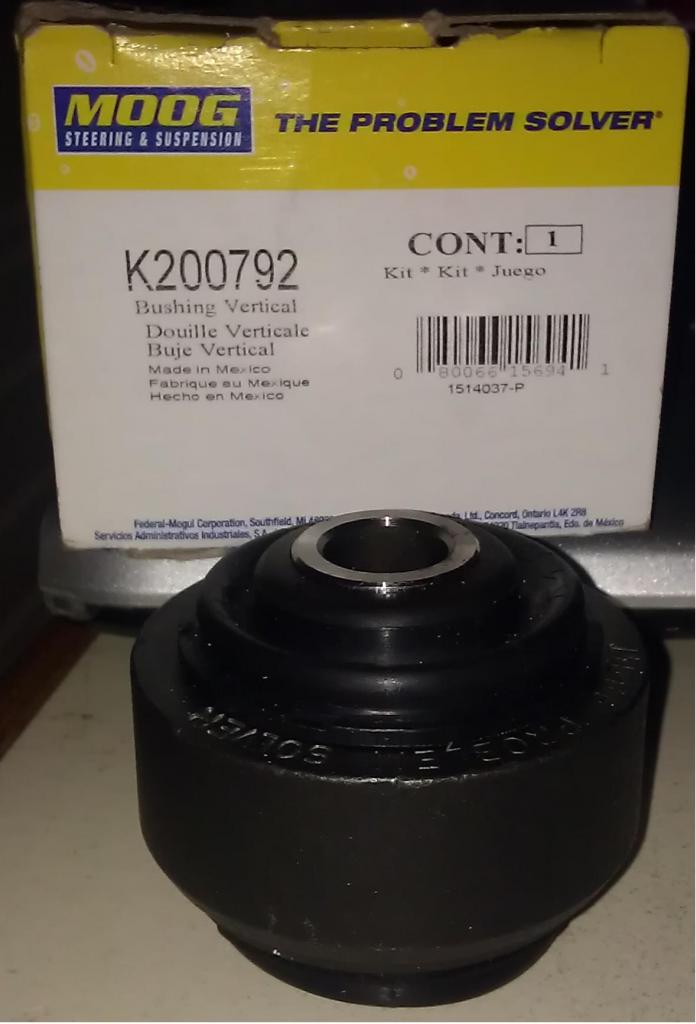

I'm still of the school, press out the old press in the New for the LCA bushings, Moog K200792, and their bolt in ball joints K80567
https://www.google.ca/search?q=moog+...iw=320&bih=460
Scroll down for my shot of comparing rubber OEM bushing compared to the Moog unitName:  IMAG2325_zps338a1854.jpg
