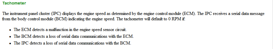

This is the etirety of what the Shop Manual has to say:

Yeah, no, it never goes to 0 RPM. I took the car out today and it is no longer even moving and it is pretty much stuck pointing straight down. I am not sure if the battery thing will even work. If I physically move the needle by hand will it damage the tach? I suppose no more than it already is. Would that possibly indicate a short on the wire that goes to the tach?
Where does the wiring harness go from the gauges? All the other gauges, lights, and displays work on the dash so maybe it is just the one wire controlling the tach.
Old Jan 11, 2017 | 05:31 PM
Posts: 26,541
That's what "serial data" means.
