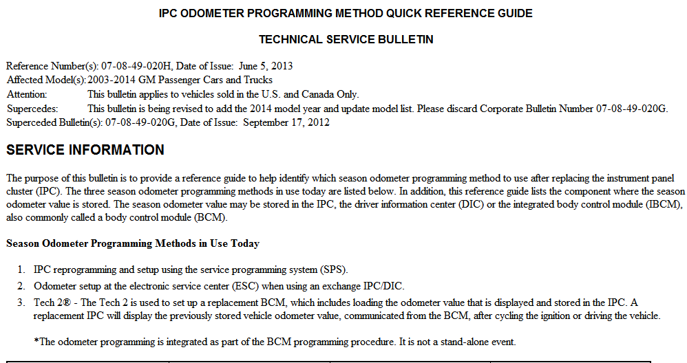

The tech2 site says that any module can be programmed via the SPS (Service Programming System). The dealer may be under the impression the mileage is stored in the cluster like many other cars, changing that mileage can be a bit tricky legally. However, in the HHR the mileage is stored in the BCM, and can be extracted with a Tech2 or similar.
Changing the odometer reading is a legal thing, most cars have the odometer data stored in the instrument cluster.
Here is a TSB, the HHR is listed as a IBCM system

One place I read that the IPC retains the last reading that it got from the donor car BCM. When that reading does not agree with the stored reading the odometer will not work. The fix is to reprogram the BCM from tisweb.
This thread from Snap-On forum is confusing, but contains info. GM BCMs, Instrument clusters and milage - Snapon Diagnostics Product Forums
