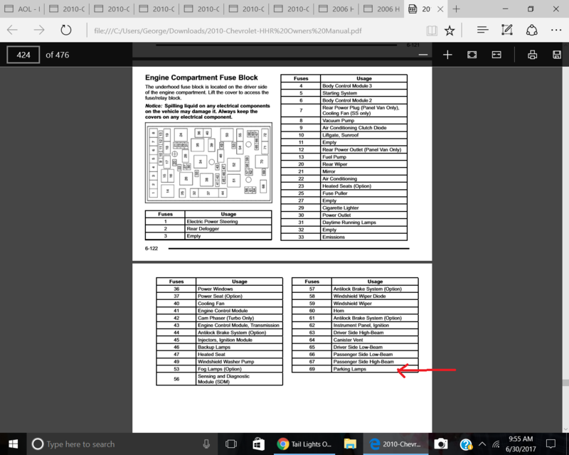

Post #1 says tail lights, so start here.
Attachment 21981
It was a blown fuse and a bad relay
Relay # 68 and fuse # 69
