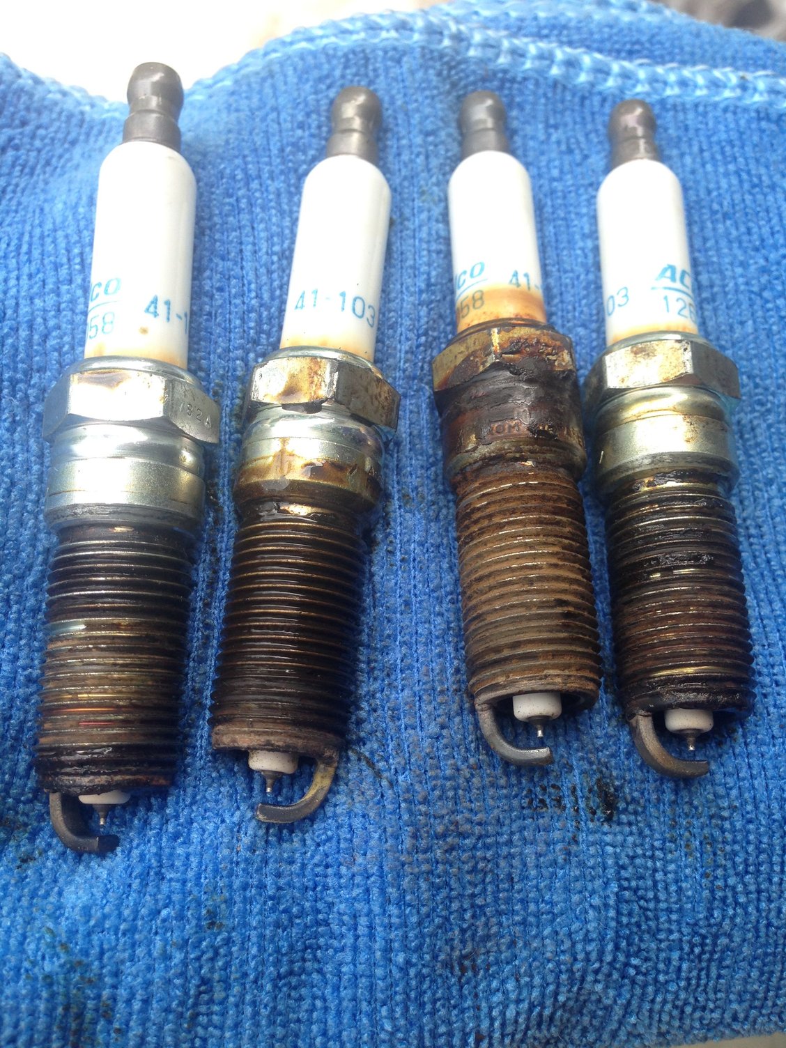

Yesterday was quite the ordeal. I pulled a spark plug to see just how stupid I was that day, and it was the right one and looked great except the threads were totally trashed. With oil. I put it back in, thought for a while, and then pulled them all.
It looks like I still have clean combustion for the most part, better than some oily plugs I've seen. But I pulled the valve cover off and replaced my valve cover gasket and the o rings on the spark plug holes and screws and etc. to stop that leak. It wasn't a very bad one. (edit: Typo)

That #2 plug looks a little oily. Maybe the rings are having trouble. A Seafoam top clean might help (put 2-3 oz in each cylinder, let sit overnight). #3 might have some coolant on it. Where they all seated tightly?

Oh no, where could coolant enter the system? I put a full new set of gaskets on but I didn't look anywhere for coolant. The weird thing is the seemingly clean combustion. But yes they were seated correctly and all that. Never got an engine code about it either. Could really use my car's help telling me what is up :)

Coolant gets in by a bad head gasket. Check the coolant level in the bottle as well as under the cap.
#3 looks like a coolant leak. Steam cleaned inside the chamber and steam being pushed out past the plug ( the orange stain on the insulator). #2 may be from oil getting past the O-ring on the valve cover and pooling around the plug.
Don all 4 plugs don't look bad. No build up of carbon or oil on the tips. The stain isn't from coolant on #3, more than likely it was oil passing by the center seal of the valve cover in that hole to cover the base of the plug and oil cooked it.

#3 looks steam cleaned and orange on the insulator too me. Maybe internet color. Suspiciously no carbon, I attribute to a recent change, but that's a lot on the threads for that.

Here's a few other pics of plug 2. It was the first one I pulled when I was checking the part number. You can really see the goop better and coloring is more realistic.
