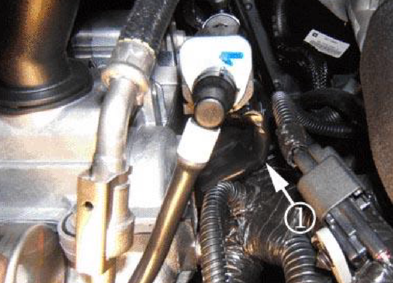

Both of those codes are TCM communication faults. I would be looking at wires and fuses.
The connector on the bottom of the trans passenger side is the vehicle speed sensor. It is vulnerable to varmints and running over things.
Fuse #43 under hood.
You might try disconnect/reconnect the TCM connector. (disconnect negative cable on battery first).
Is the "Darth Vader" plastic hood still covering the ECM & TCM? Any chance that somebody touched the TCM with a hot wire?

oldblue is right itsa ground problem if you cant find the bad ground buy a jumper ground wire and jumper its from the gnd spot on ur body near the strut to the tcm itself ( its predrilled) this will fix the issue if your stuck in first gear no power steering no speedometer ect...

The hood is secure.
I think I'm going to have to ring out the TCM>Trans connectors
