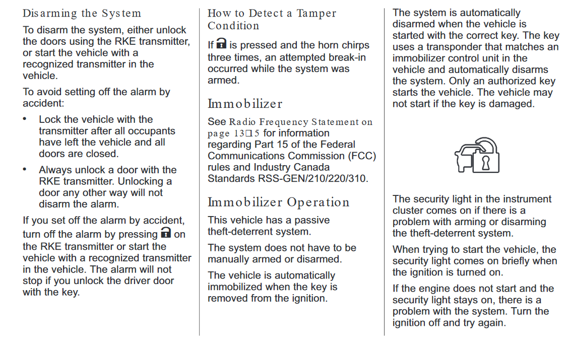

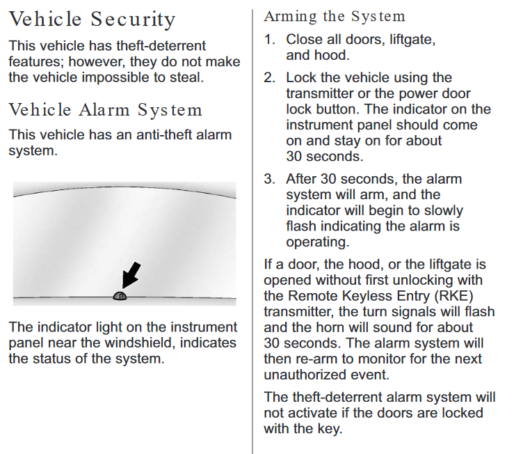

I cannot write in any language but English. Here are the relevant passages from the 2013 Sonic Owner Manual.
The lights are supposed to stay on for about 10 minutes after you remove the key. That is in the manual, also.
