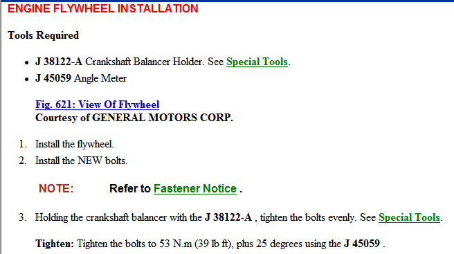

I notice that a lot of sites that sell replacement flywheels for the Ecotec say that you have to replace the flywheel bolts.
The flywheel bolts are rather pricey (about $50 for the set).
Any suggestions on whether I really need to replace them?
Thanks
Steve
Thanks
