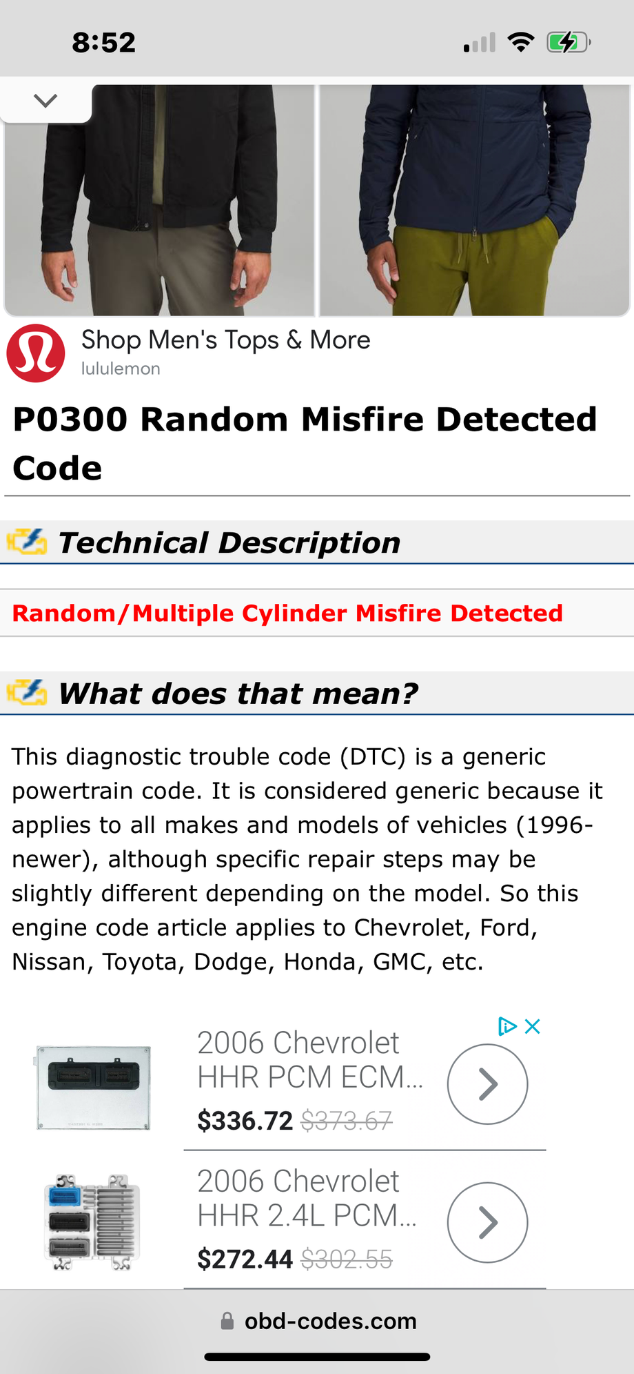

P0300 is a code for a random misfire detected
https://www.obd-codes.com/p0300
Possibly a ground wire loose, fuel injector connection or spark plug coil connection
Also a possible burnt exhaust valve, doubtful if just lapped in the valves

Correction: P0300 mean "misfire detected".. Leave the "random" out.
It means that the crankshaft is not turning at a regular rate, as if there was a misfire but no reliable information to narrow it down to which cylinder.

No correction required, the code is about a random misfire, not a specific cylinder
