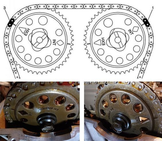

Thank you greg8453 for the link, this is far better than Chilton. However this doesn’t clearly state TDC on the compression stroke or TDC on the Exhaust stroke. My engine on the compression stroke does not align with the drawings.
Quote from link, “5. Locate the number 1 piston to approximately 60 degrees before top dead center (diamond shaped hole on intake camshaft sprocket at 12 o'clock position).
This does not make sense, TDC compression stroke the diamond was not at 12 o’clock. Instead I have the triangle at 2:30.
I am going to put the old parts back on and rotate to TDC exhaust stroke to see if the triangle and diamond match the drawings.

I honestly think TDC compression is wrong.
My engine at TDC compression stroke does not look like the drawing.
