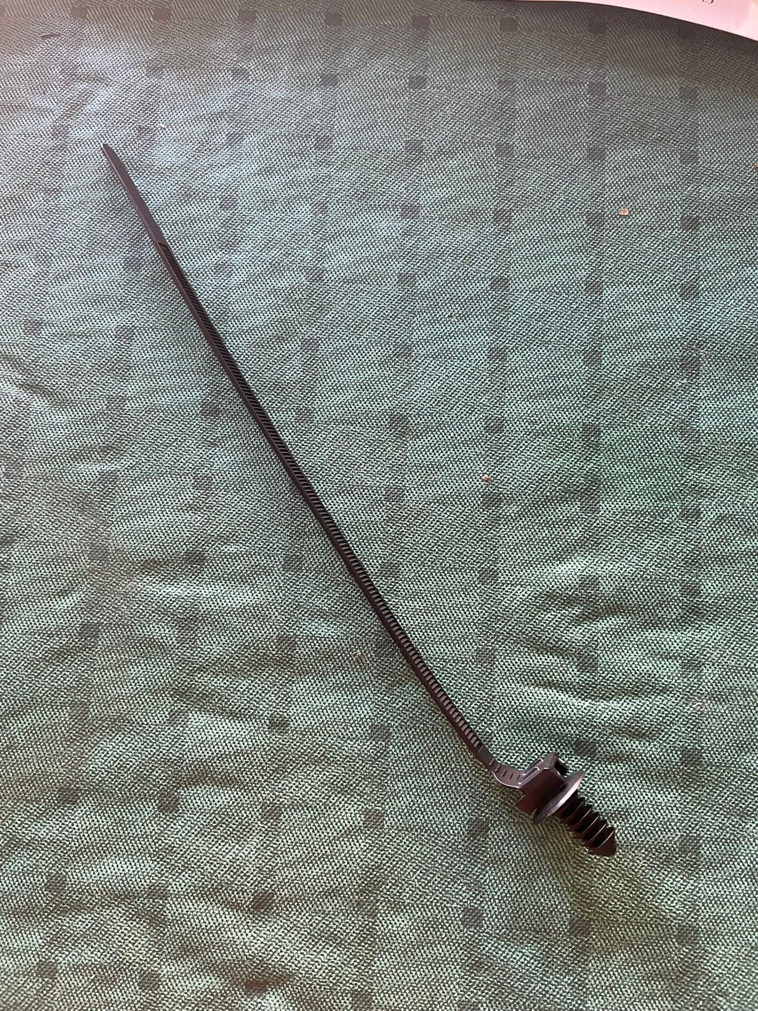

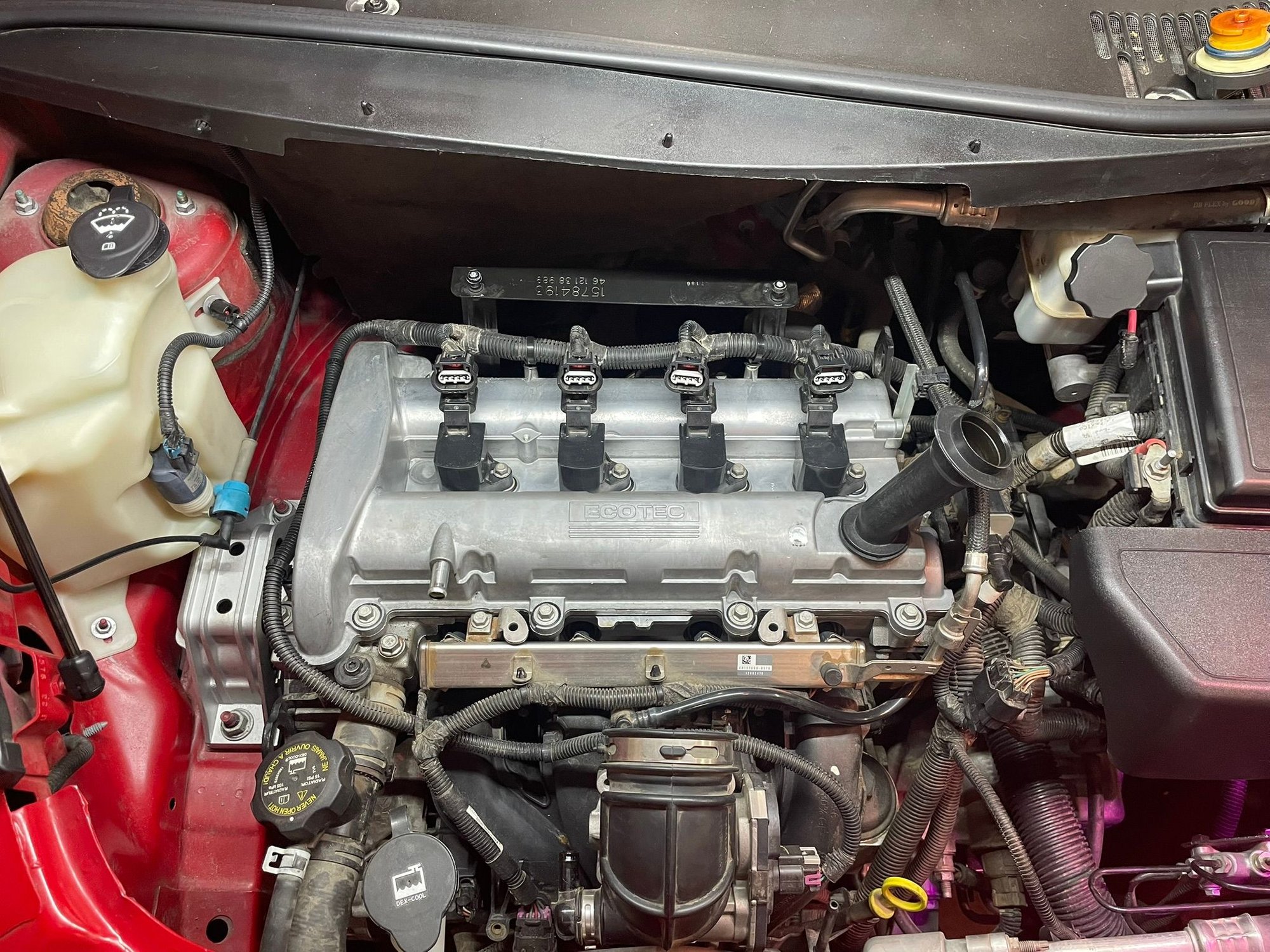

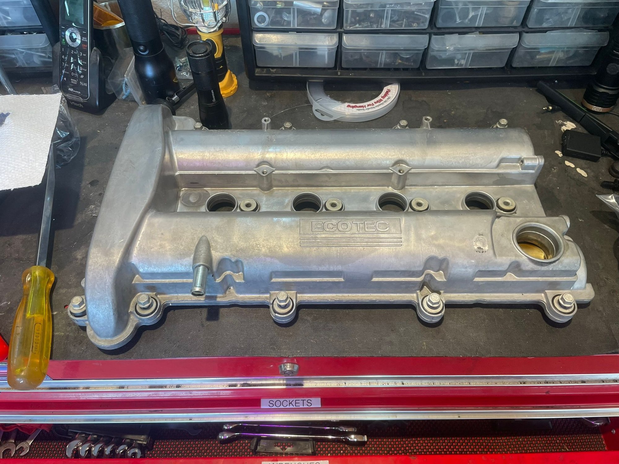

First step is to remove the valve cover, all the bolts are 10 mm and the coils have to come out. The harness has to be cut loose, new zip ties are available but have to be slightly modified to work. I used a grinder to grind down the pine tree and screwed in the tie before installing the valve cover, with the aid of a little grease.

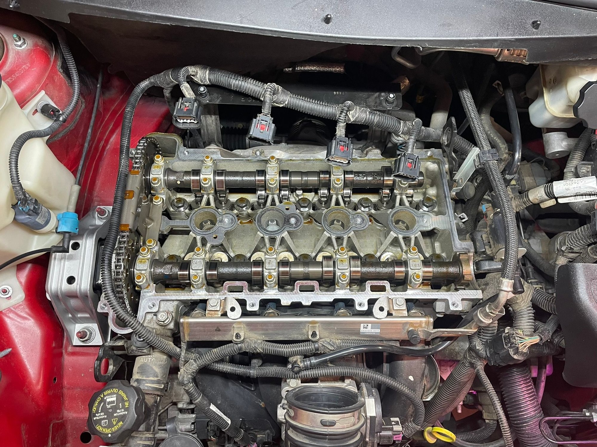

NOTE- this is a good time to inspect all 16 cam lobes and rollers for abnormal wear.

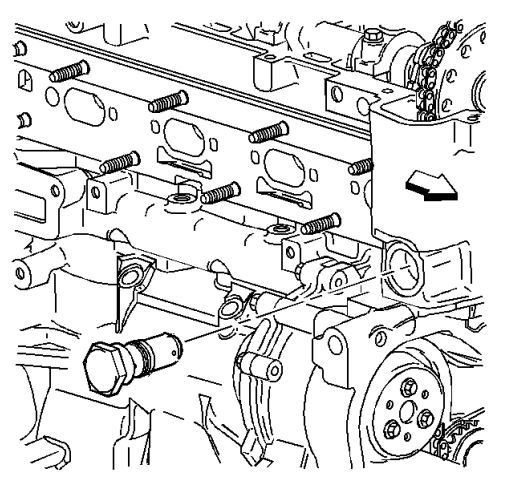

Inspect the chain guides, there is one below each sprocket. Both should be complete, if either is broken you have more of a repair to do- replacing the chain and guides- which isn't too difficult. If all is OK, then you can proceed to remove the old tensioner, which requires a 32 mm socket, and make sure the entire tensioner comes out with all the parts. The chain should stay in place, it doesn't have to be rotated to TDC or any particular position beforehand. DON'T rotate the engine backwards, this could throw slack into the chain and jump timing at the crank sprocket. Just don't rotate the engine at all.
Screw in the new tensioner and torque to 55 LBS. NOTE- I soaked the tensioner in oil with the hole at the top so it could fill with oil first, essentially priming the device and getting the air out. The slot on the tensioner will line up with the chain guide automatically.

That's it, this is not a complicated proceedure. Clean the valve cover and install a new gasket, and replace the 14 donut seals, too. You only need a vise and a screwdriver to replace the seals, pry them off. Screw in the zip ties before installing the cover, it's a lot easier that way.

Clean up the valve cover, install a new gasket and the 4 zip ties for the wiring harness.
This is the only zip tie I could find that will work. Grind down the pine tree at the end until it will screw into the threaded holes easily, using lithium grease.
Inspect the chain guides, they are visible below each sprocket towards the outside of the engine. They must be complete.
The black and the white guides are what you are looking for, the white one will appear yellow like the balance chain guides.
The tensioner is on the back of the engine. Loosen with a 32 mm socket.

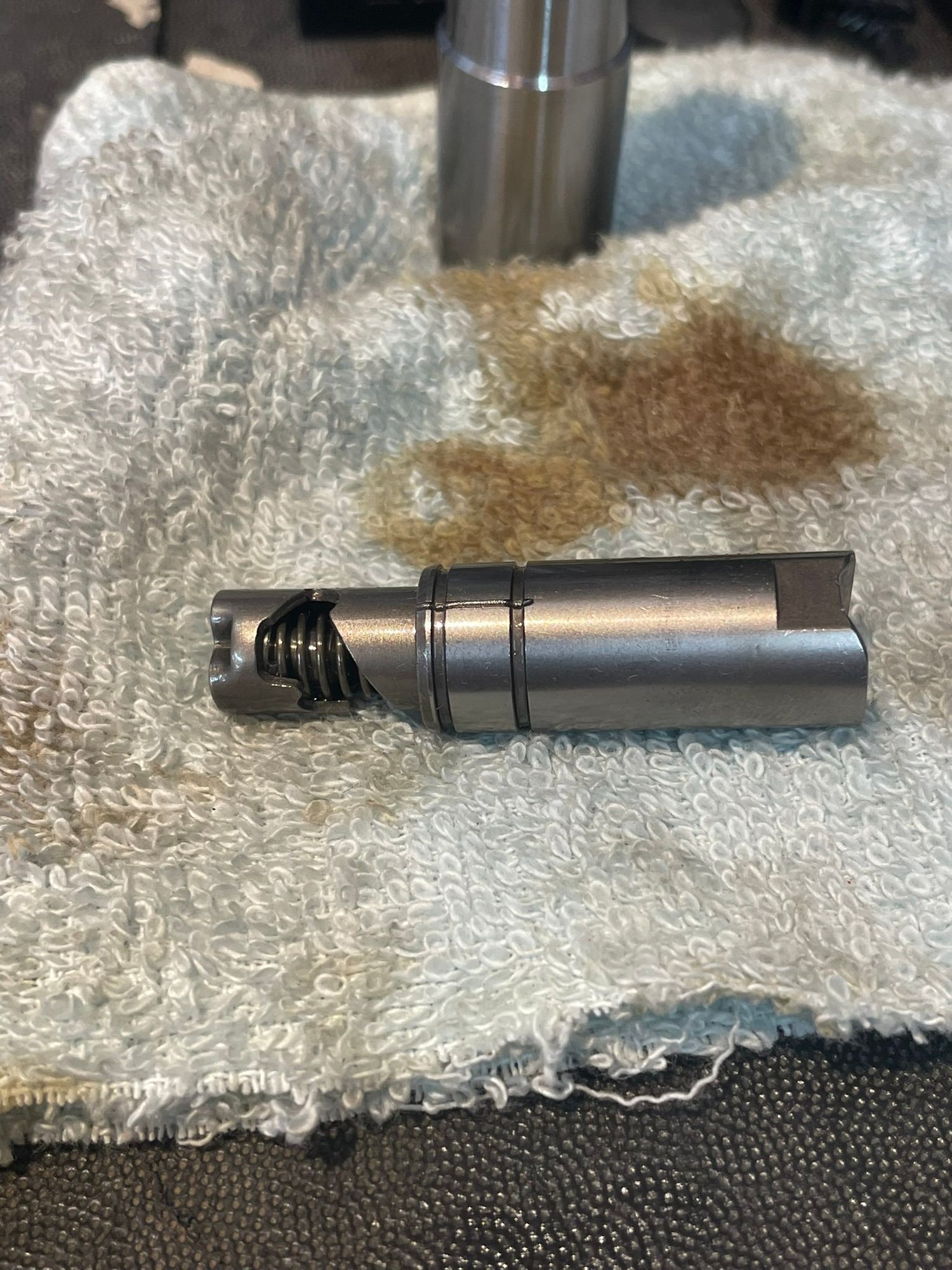

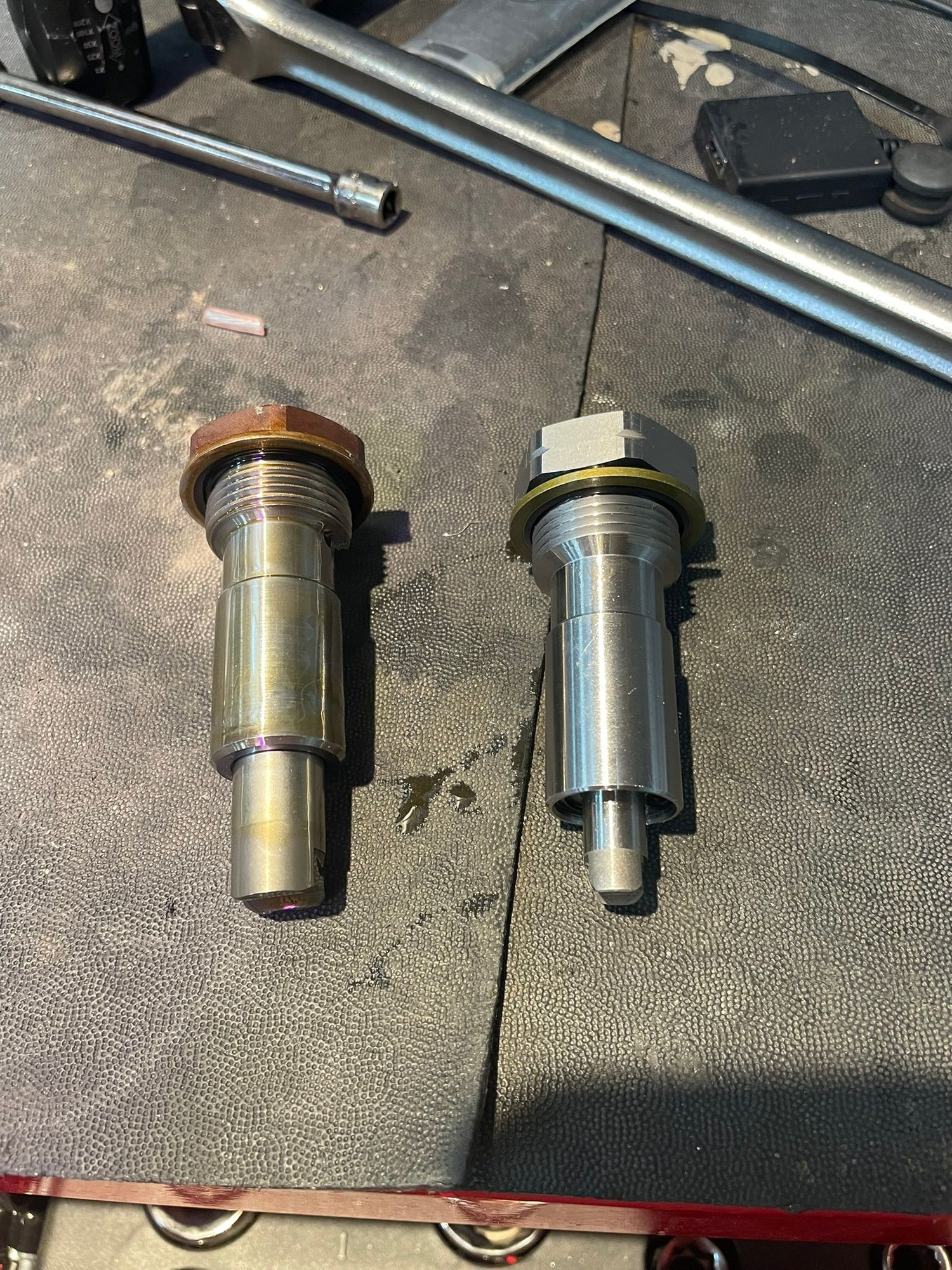

The defective OEM tensioner is on the left, the new is on the right. DO NOT activate before installing! It is normal for the shaft to slide in and out a few millimeters. The oil fill hole is near the washer.

Your OEM tensioner is the one for the 2.2 non VVT units, the new one you installed is the OEM style for the 2.0 and 2.4 engines with the VVT system.
