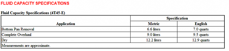

When you just drop the pan that leaves about a gallon of ATF in the converter.
