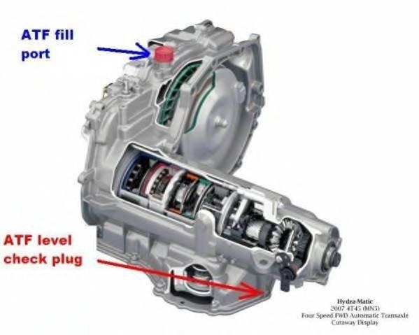

2006 came with Dex V, however GM changed the recommendation to Dex VI in a TSB. So don't sweat the Dexron part, it's basically a change from dino to syn. But, it might be low if they did not know how to check the level. SEARCH "transmission fluid".
And I'm sure someone will post the drawing of the component locations.

Lucky's Avatar
Joined: 12-24-2007
Posts: 2,873
From: Seville. OH
Like this.

Posts: 26,484
I thought so. Do you keep it on your clipboard?
Old Feb 19, 2014 | 08:50 PM
Lucky's Avatar
Joined: 12-24-2007
Posts: 2,873
From: Seville. OH
I keep them in my photo album
