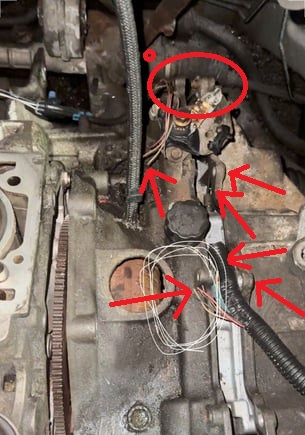

Any information on this issue
Can’t get the transmission separated from engine bell is still attached do I need to counter rotate the cam shaft?

Did you remove the torque converter bolts?

Cam shaft. Uh, those were removed with the cylinder head.
With all those wires cut, I don’t see how this car was ever working before.

That is separating at a bad angle. You need to separate them evenly. I think it may be hung up on the alignment dowel.

An alignment dowel or a bolt was forgotten. The torque converter has to be with the transmission, not the flywheel. There are 3 bolts holding it.

Lots of odd things going on in this picture. Cut wiring. Loose, partially separated transmission casing. Cable bracket under the casing ?
My copy of the pic may be a little blurry so also look at the OP's original above.

I’m thinking that last bolt on the top to our left isn’t all the way out. I remember someone else had this issue awhile back.
