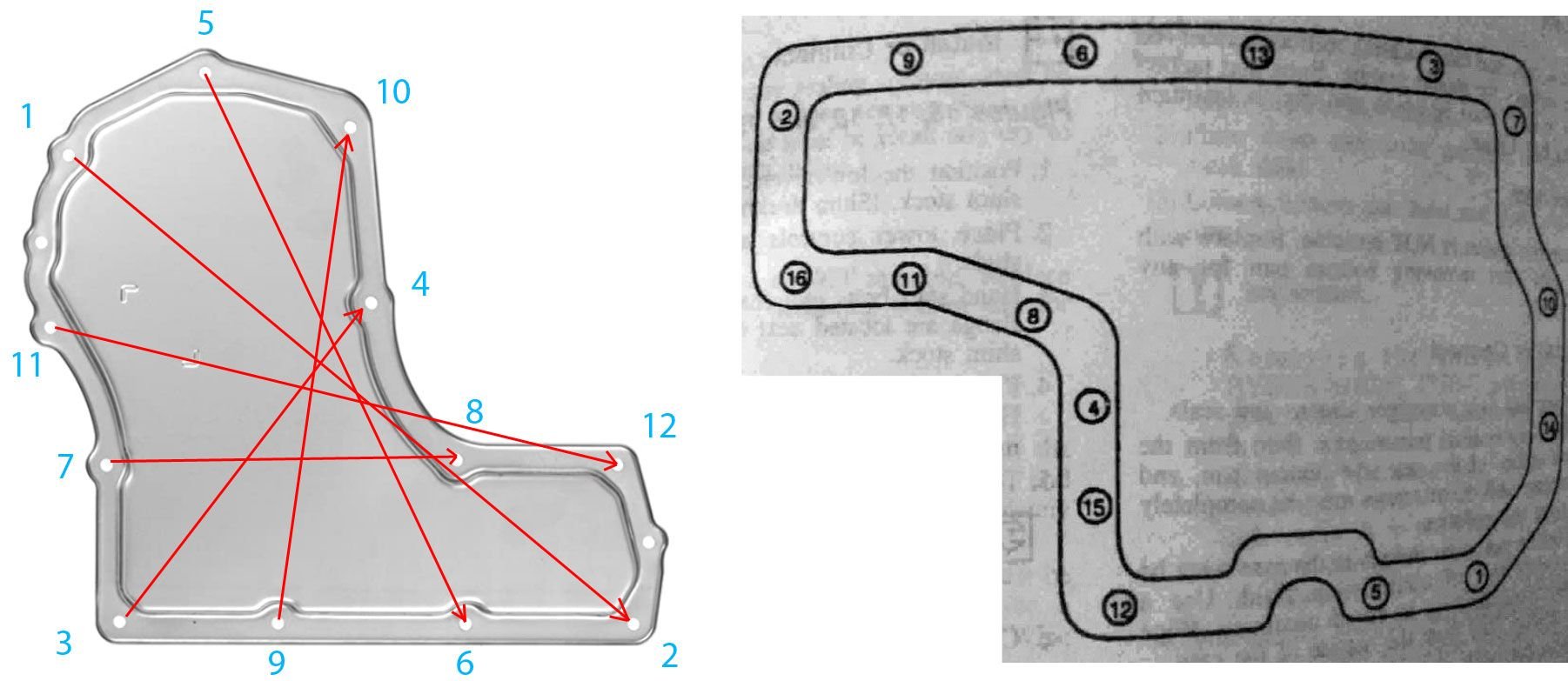

Old Mar 18, 2020 | 12:13 PM
slonny's Avatar
Joined: 07-20-2016
Posts: 169
From: LA, CA
I assume there is no correct tightening sequence for transmission pan bolts. I decided to use alternating pattern that I got from another manufacturer.
Does 89 ft/lbs sound about right for these bolts? Couldn't find any any torque values on Tightening Torque Values for Common Maintenance Items page.
Drain plug seems to be 28 lb ft, but last time I torqued it to good-and-tight torque spec and everything seems to be okay.
Old Mar 18, 2020 | 02:29 PM
Posts: 11,721
NO ! 89 ft lbs on the pan bolts and you're going to destroy the pan or the gasket. That sounds like the torque value for the mounts.
I would think the pan bolts would be no more than 20 ft lbs. Maybe less.
