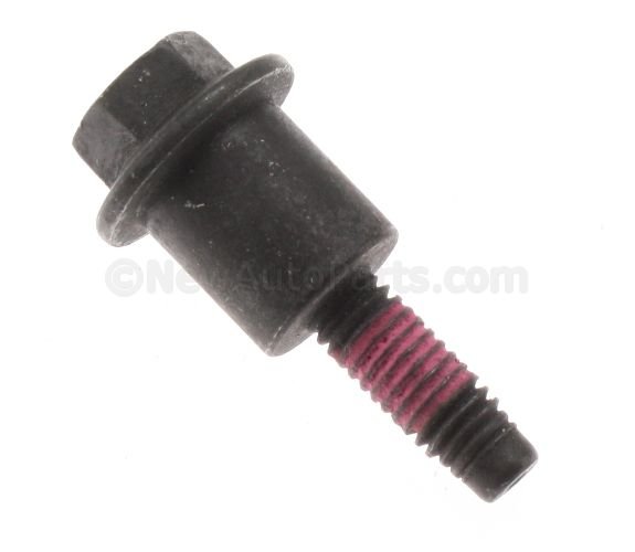

Did you install a replacement bolt for the front upper guide (the black plastic one)?
This is a Dorman bolt, it eliminates that top bolt from breaking and cause the guide to shatter

Hi, yes I replaced those guide bolts for that, but with the same ones that were there before. Is that picture the same as this?
Is it fine using those?

From: California
No, not the same. You can replace it easily. https://www.chevyhhr.net/forums/how-...de-bolt-62897/

This is a explanation of the guide bolt problem

Oh wow okay, I'll look into buying that and replacing the bolt soon! Thanks for the info about that bolt!
