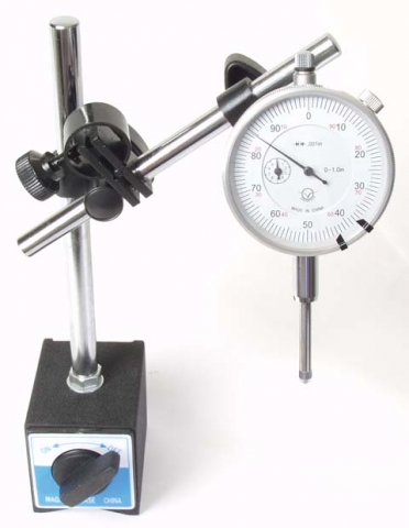

Old Oct 6, 2010 | 11:56 PM
Gotta start somewhere: I'd check both front wheels for excessive end-play, with a dial indicator.. Should be less than .002
Also look for any spots on inner rims that may be missing wheel weight(s)...
