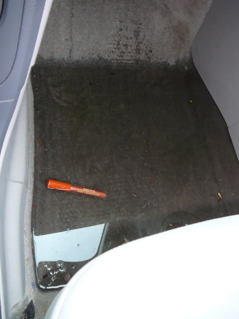

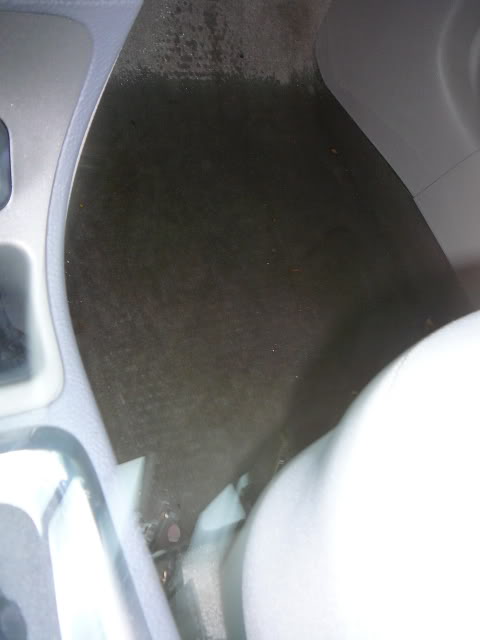

Well since they fixed my leak on the first try (so I hope) fingers crossed and the smell is gone I think it's okay, once it dried out. I did take pics of the leak just in case it decides to come back.
I dropped my lipgloss leaning over taking the pic, you can see it's over an inch deep.

Holy crap!!! I've never seen that much water in a car before! That is crazy...knock on wood, I hope that issue has been fixed in the 07's! I've been through some heavy rains and a car wash so far and nothing yet
Yipe!! Did you have a Life Guard on duty?
