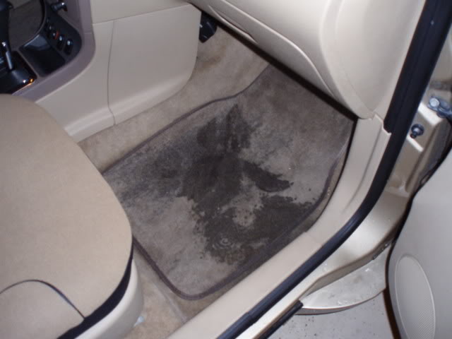

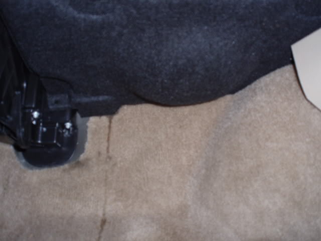

Old Apr 3, 2008 | 06:13 PM
  #315
tooter1's Avatar
Joined: 02-22-2008
Posts: 365
From: Tennessee
I have a water leak!!!
Well I got off work and get in the car and it is soaked on the passenger side.
We had to have the windshield replaced about three weeks after we bought it, dealer paid to have it done.
Yall that it could be from this being replaced?
It has been pouring out, they said this morning we could get up to 5 inches of rain over the next couple days.
Looks like I have to take it to the dealer. I guess.
Wet floorboard
Under the dash, that panel is soaked also

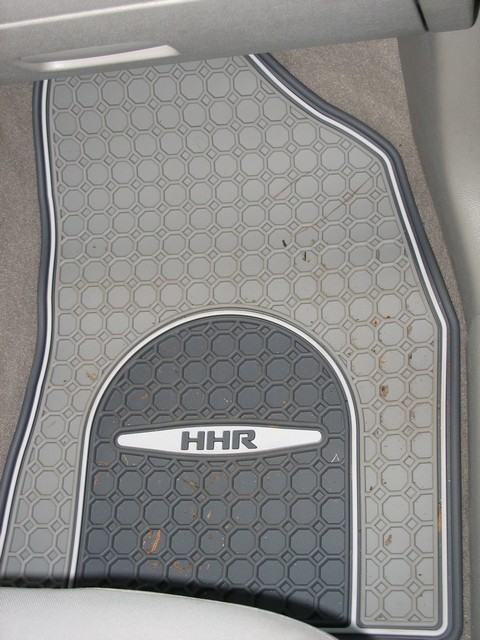

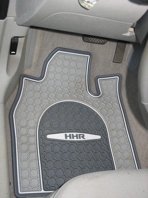

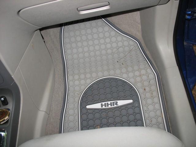

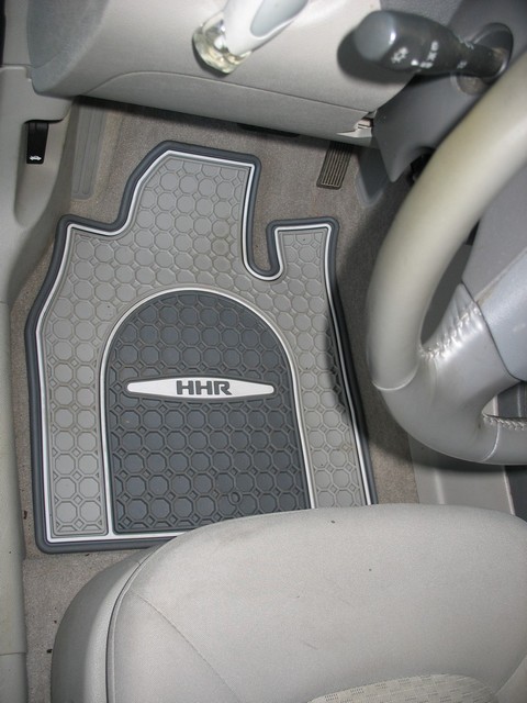

Old Apr 6, 2008 | 09:49 AM
  #317
max3456's Avatar
Joined: 05-17-2007
Posts: 96
From: Spring, Texas
All Season Floor Mats
When GM replaced my carpet and floor mats I asked that they replace the carpet mats with all season mats. This should make it much easier to clean and better protection for my carpet. I think they look great.

Old Apr 6, 2008 | 02:08 PM
  #319
Snoopy's Avatar
Joined: 05-09-2006
Posts: 6,805
From: "Upland" Mesa, Arizona
I really like the two-tone coloring and style of those mats. It looks well with the grey carpet.
But they don't appear to be styled specifically for the HHR. Notice the space between the gas pedal area and the brake pedal area. Really is no need for that since the mat doesn't reach up and behind the pedal (which may be a good thing, based on some pedal/floor mat reported problems).
But they do look nice.
