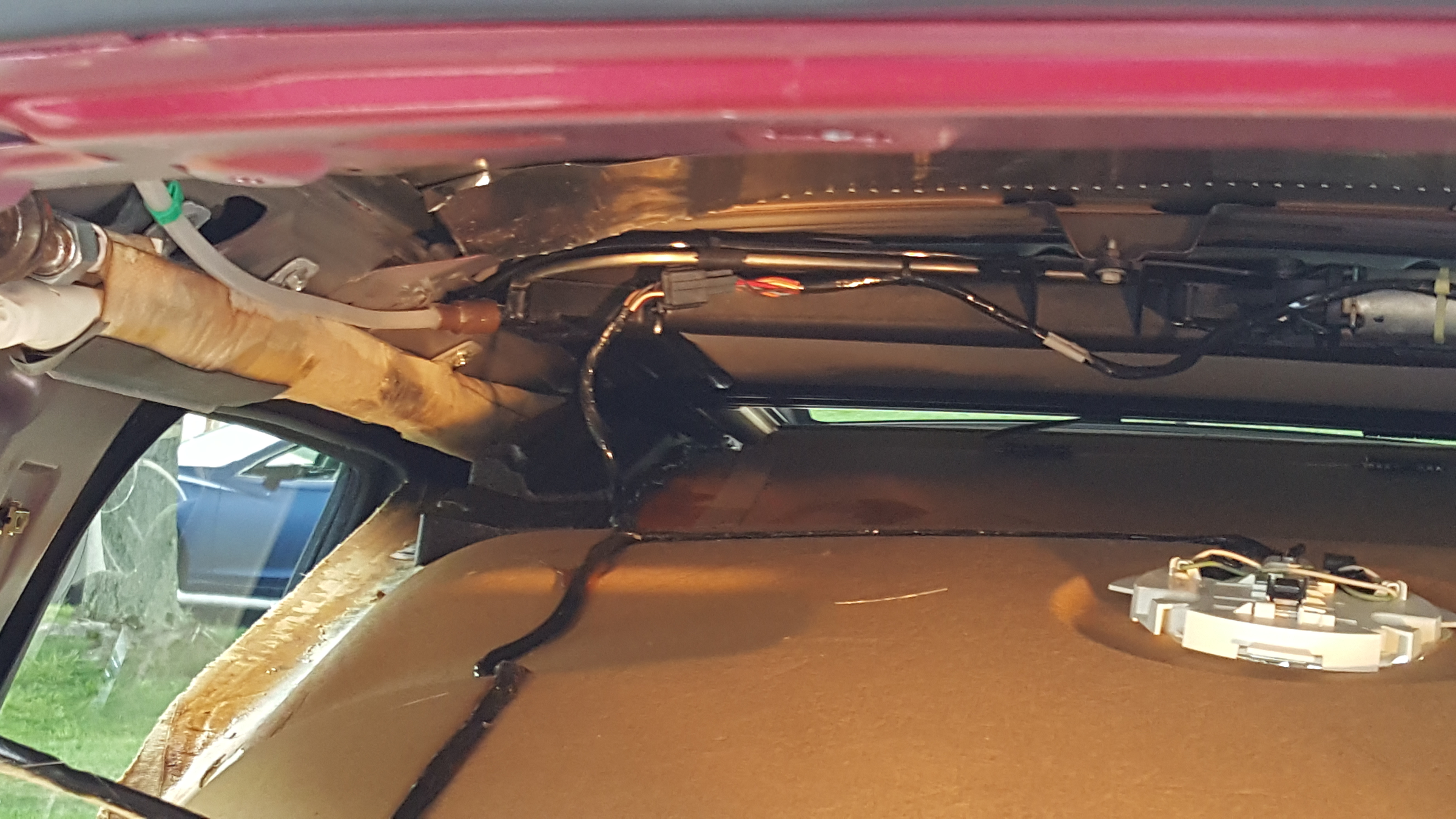

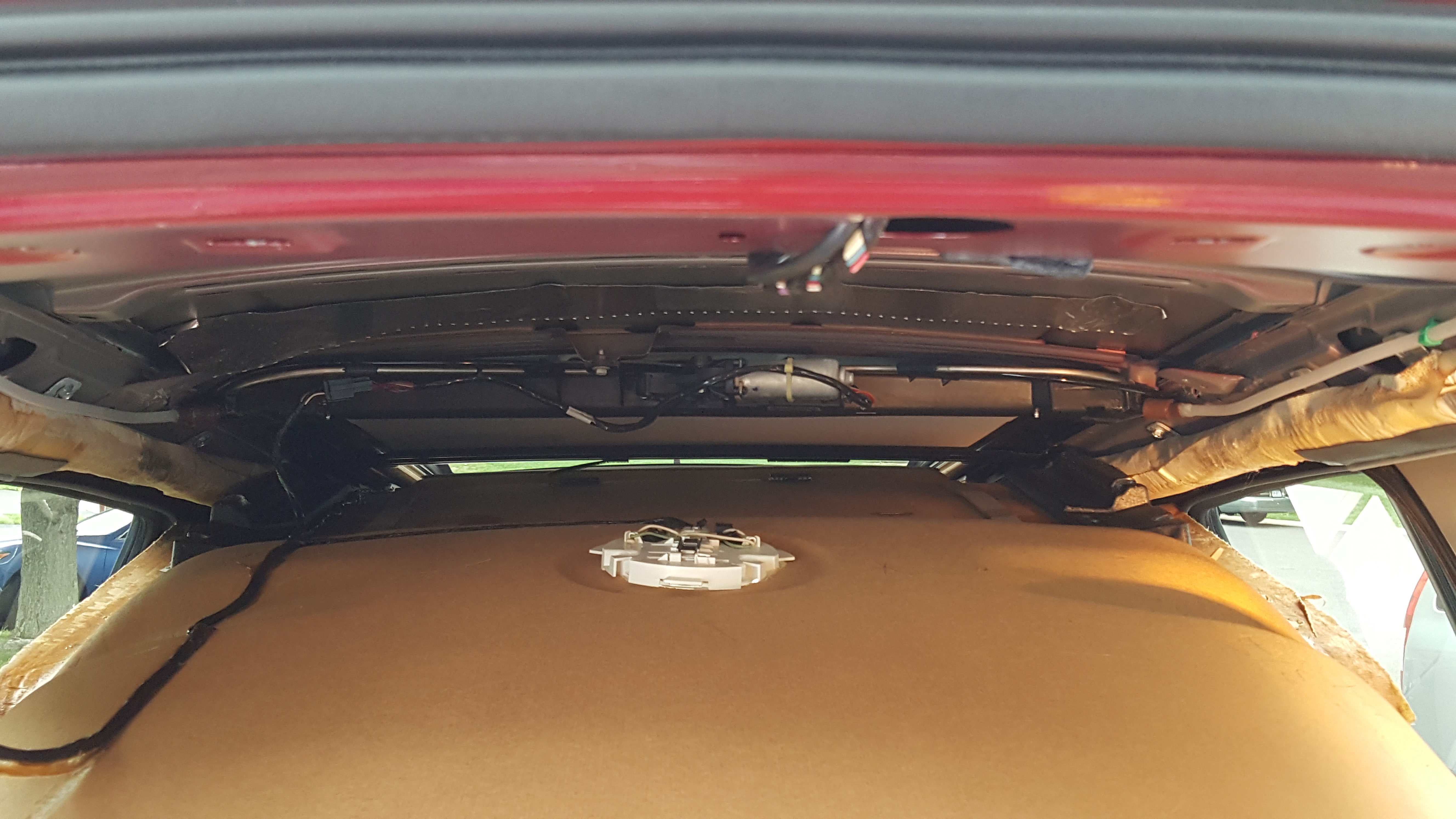

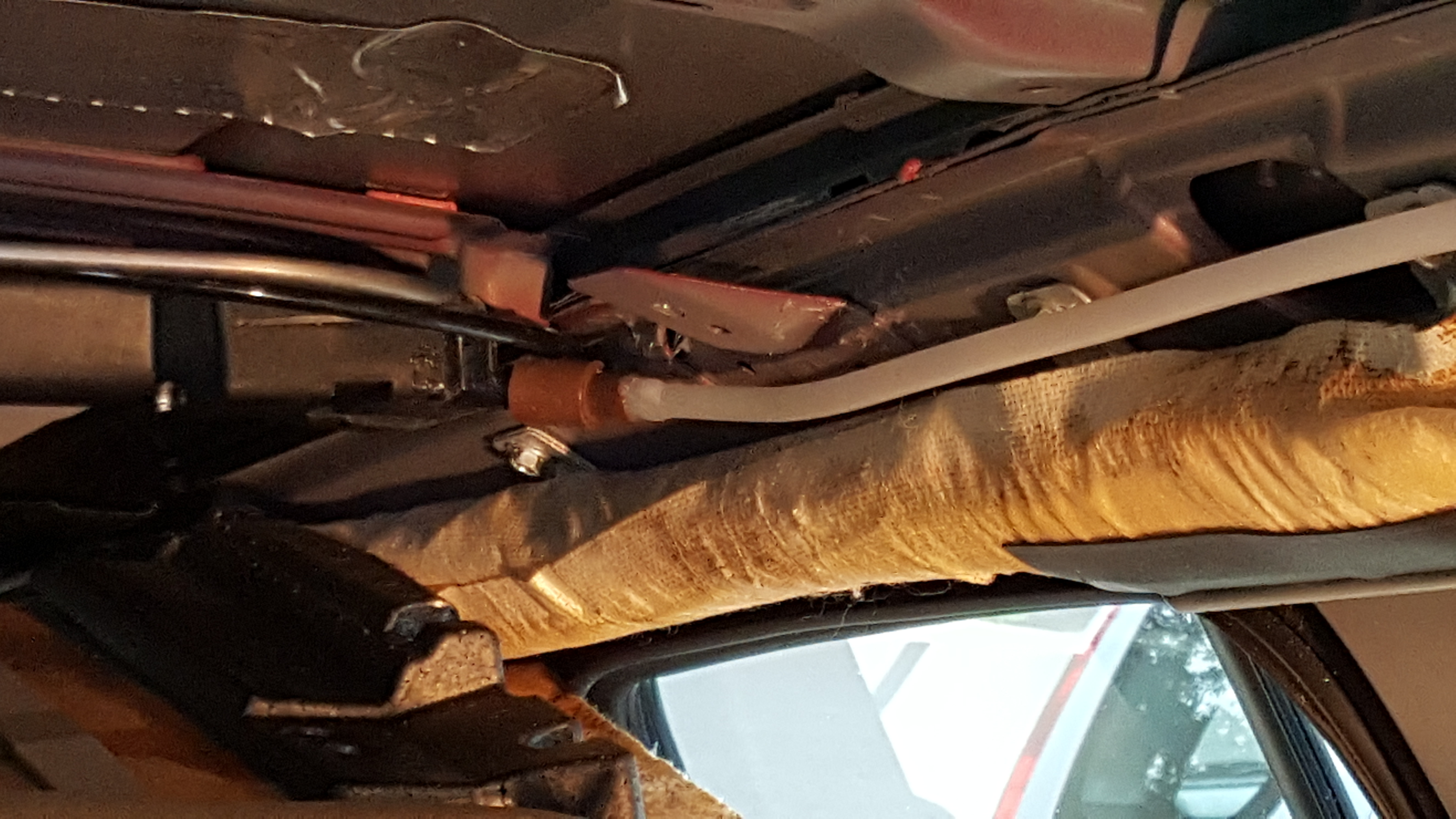

Of course if you don't know by now the HHR has several areas where leaks are know from the blunt patch up front on the passenger side windshield area to the sunroof. I live in the northeast area where we have to deal with leaves and debris from the trees. I have been noticing I would have to clean out the drains every year. There are 2 drain holes up front that you can see when the sunroof is down and the other 2 are at the back section where the sunroof goes down in to the roof. The drains are really hard to get to and the only way was to drop the rear section of the headliner. I have a couple picture of the 2 drain tubes and if you see in the pictures where there are brown rubber connector where it attaches to the drain and the tubes that go back to the spare tire area. I have not seen any picture of this but hopefully this helps anyone trying to fix the leak.
