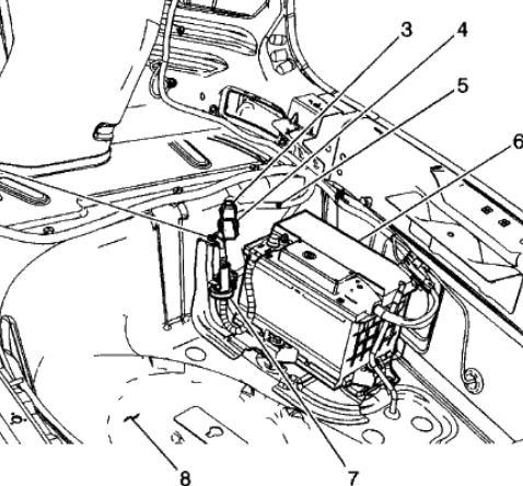

Is the current sensor on the negative battery cable?
#7 in this:
