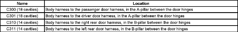

The Connectors which split the power are noted below. Use the Diagrams below to see where they are located:
C300 - Front Passenger (#9 In Below Diagram)
C301 - Front Driver (#40 In Below Diagram)
C310 - Rear Passenger (#14 In Below Diagram)
C311 - Rear Driver (#35 In Below Diagram)

Window Connector Location Descriptions:
