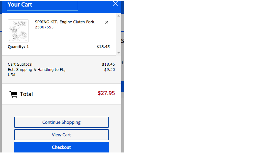

Thanks so much for your statement, "But again, change out the spring kit first, see what happens. K01 spring kit includes #9, 10, and 20", because i was trying to find 9, 10 and 20 and didnt see it on that page! so, you saying that K01 is all of that, life saver! thanks mate. Weird how on that page, it says "transmission type: Automatic" and yet the title is manual 5 speed! that website is a bit jacked up!
Ill go ahead and google the part number (25867553), and i assume i dont need K01 anywhere in my search. Although when i scroll down to K01, i dont see any "unavailable", just the + for quantity and the shopping cart. Ill add it to the cart and see what it does, just for the fun of it! AH I read it... you meant the sensors.... sorry, im not reading very well today.... LOL... ill order the K01 now. thanks so much, you are awesome!
Thanks again, DeVoiD.
