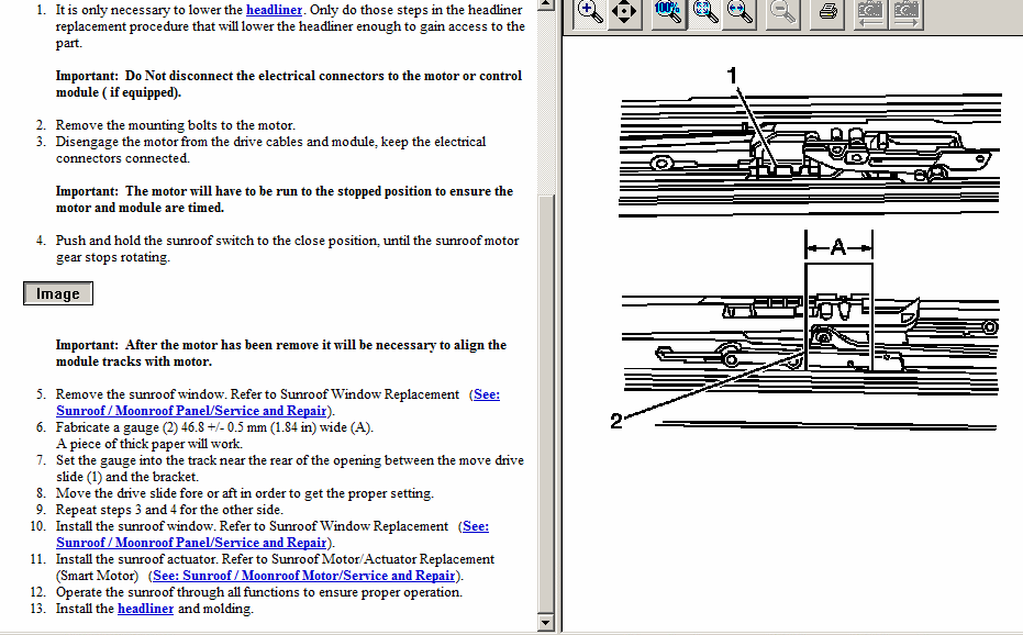

Old Apr 11, 2016 | 07:17 AM
Posts: 26,536
I don't know for sure, but I think there is a TSB or 2 re moonroof/sunroof noise.
This might help:
