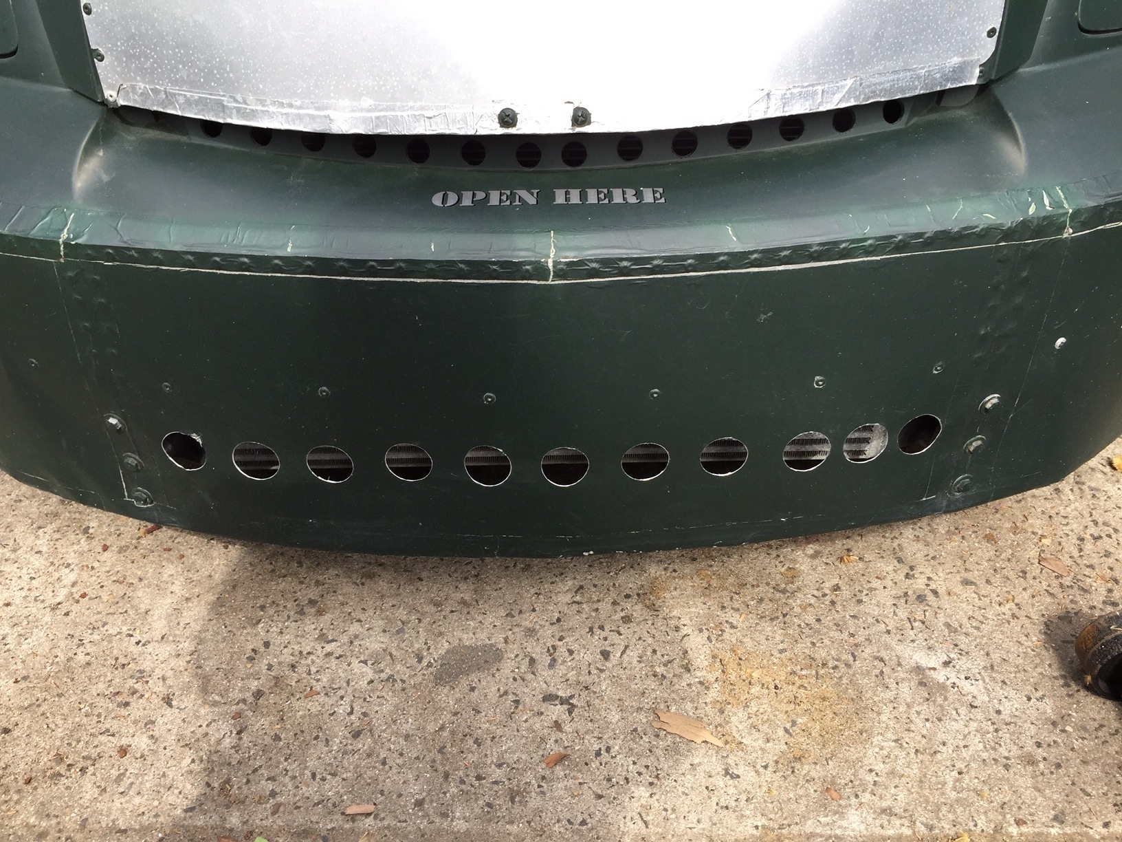

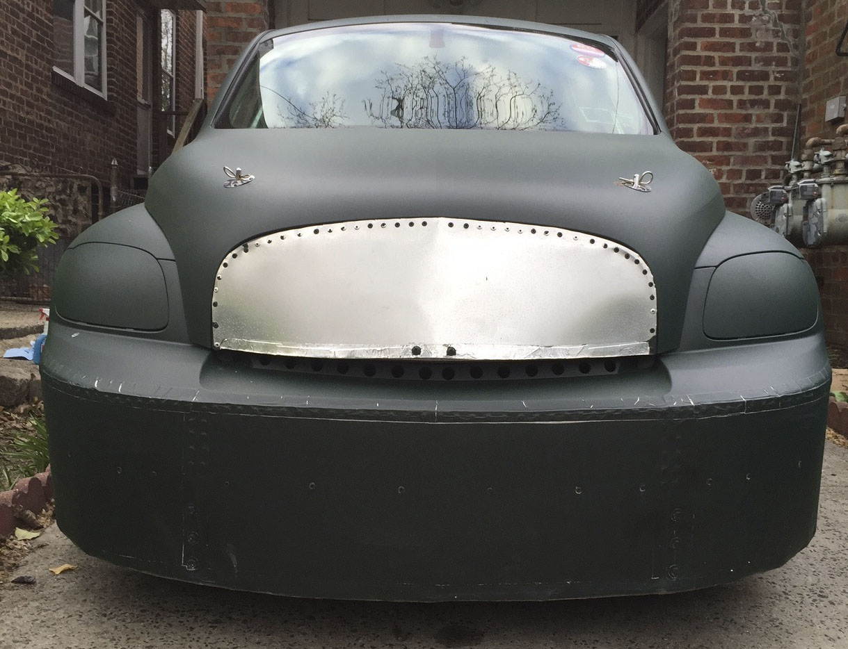

Dennis, here's a before and after shot of the front bumper cover. I ran it the old way through the July event in Maine (went 148 with some backfiring in the 1.5 mile), then used a hole saw to cut two-inch holes in the cover to get more air to the intercooler, and went 153 with little or no backfiring in the mile. (The smaller holes that you see just under the grille were always there, and there's a fairly large opening under that aluminum grille cover, too.)
Not sure if these openings will relieve under-hood pressure, but they definitely seem to get more air to the IC. I'm also going to brace the bumper cover behind those holes--as you can see, it started to cave a bit after the 153 run...

I understand where creating air flow over the intercooler would be beneficial considering the boost levels your at. Compressing air also heats it and can cause a number of other issues as you have found out. With our boat engines we used water to air heat exchangers to cool the air when boosting. A luxury you don't have with a air to air intercooler.
Are you still using the seal at the back of the hood? If so removing the seal and opening up that area at the cowl should help relieve any under hood air pressure. I would also block off where the HVAC inlet to the fan to make sure air and fumes aren't getting into the passenger compartment at that point.

Isn't the back of the hood at the base of the windshield a high pressure area?
Why are cowl induction intakes made?
I would rather see vents on the sides of the fenders ducted into the engine bay or at least lovers in the hood.
Air flow onto the intercooler could be possibly made better by using a NACA duct:
https://en.wikipedia.org/wiki/NACA_duct
Just my 2 cents.

I've had the flex problems and solved it by using a Greenlea hole punch instead of just a hole saw, it bells the edge for strength some tool rental places rent them
1/2-2 MS SPEED PUNCH KIT - Greenlee - Made for the Trade? 783310022572

It can be a high pressure area. My suggestion was to let any air pressure in the engine compartment out somewhere, not capture it and make it a high pressure area that tends to make the front-end light at high speed
