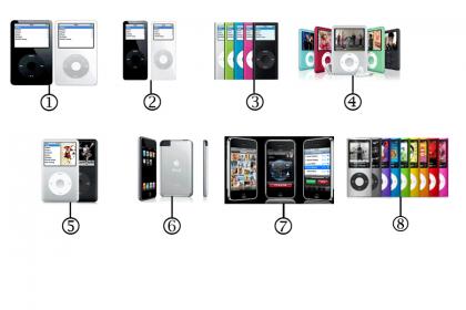

Validated Apple Device - Both Charge/Support Digital Audio (For All RPOs)
For further information on identifying iPod models, please visit http://support.apple.com/kb/HT1353
Brand Name/Description Number
Apple iPod Classic 5 & 5.5 Gen 1
Apple iPod Nano 1Gen 2
Apple iPod Nano 2Gen 3
Apple iPod Nano 3 4
Apple iPod Touch 1Gen & 2Gen 6
Apple iPhone (User must switch to "airplane mode") 7
Apple iPod Nano 4 GEN 8

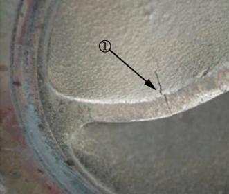

The pictures below illustrate typical cracks found in the turbocharger housing.
This illustration shows the location of the cracks in the partition wall of the turbocharger inlet flange on the left (1) and on the right (2).
This illustration shows a close-up of the crack on the left side of the partition wall (1).
This illustration shows a close-up of the crack on the right side of the partition wall (2).
These cracks are not uncommon and are considered a normal condition and should NOT be a reason for replacing the turbocharger assembly. The cracks will not affect performance. If the vehicle exhibits driveability concerns or turbocharger DTCs P0299 or P0234 are set, refer to SI and follow the established diagnostics for correction of the customer concern.
