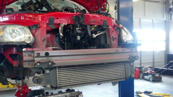

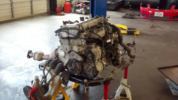

The engine is out!

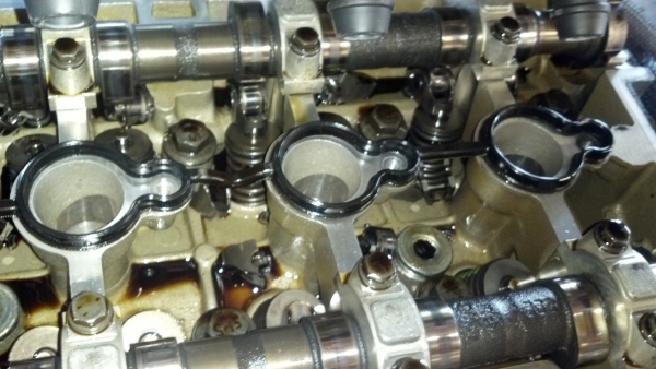

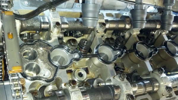

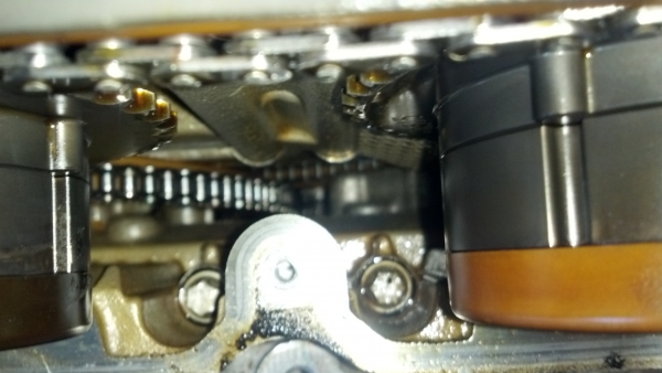

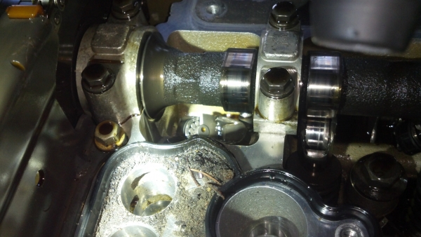

So stopped by the shop today. The old engine is out and waiting for the new one, which should be there by now... Here are some pics...
I don't know why it's so small!!!
I used to run about 190-200 with the old engine. I'll let you know how it is with the new one.

Look at all that damage.

Would be interested in seeing the tops of the pistons and the valves too but I can get a good idea of how mangled and reshaped they are from seeing these pics.

Well thanks 07azhhr for making me look like a chump. How'd you do that? I copied the BB line.
I wanted to see the pistons and valves too, but I'm not paying them to tear the engine apart just for pictures. But yeah, the damage must be bad.
I was under the impression that the timing chain had jumped off the sprocket when the tensioner failed. What had actually happened was that when the tensioner failed, the chain slacked, but still kept turning. When that happened, the cams were no longer in sync with the driveshaft, and I"m out 9000 dollars.

The piston tops have probably been redesigned lol. But many of the valves are definitely bent if not broken. The change to the tops of the pistons should lower compression a bit and allow for more boost .
