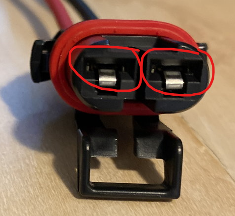

Originally Posted by gravator
Here is the eBay one vs original one. The eBay one is a little bit smaller on plastic around connector. See picture. I am going to see if this will work tonight some how and report back. I think I can get it to work if I move the green seal from old to overlap the red seal on new one.
Yeah wont work because the male connectors on the Fan Module are normal size spade connectors. This new pigtail has narrower/smaller female connectors that don't allow. It looks likes like it would lock but cant get that far. Looks like I get get by with the pre-made one from EBAY and I will need to make one with 4.8mm female connectors inside. I think with this I could get it to work or come up with a weatherproof moldable silicone that I can seal my individual connectors in without 480 Metri-Pack..... More to come..

Talking with custom connector kits website support they turned me onto these 630 versions that look spot on. Not carried by many vendors and comes up as FORD connector a lot of times hehe.
https://www.automotive-connectors.co..._store=english
I am going to try it and will let everyone know.
