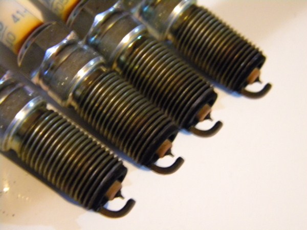

Yes I put new plugs in it at 50,000 they looked good when they came out.
