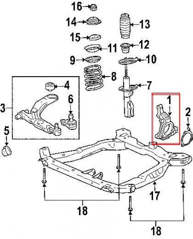

Old May 6, 2015 | 11:24 PM
Posts: 11,721
These knuckles ?
Not normally a part that should need replacing. Now, if you are incorrectly installing them or using the wrong part, that could be the issue.
A Fwiw. The SS's FE5 suspension has a different size knuckle/ball joint setup than the regular HHR's FE1,FE3 suspension.
Sounds like you could have some mismatched parts as mentioned by Donbrew above.
