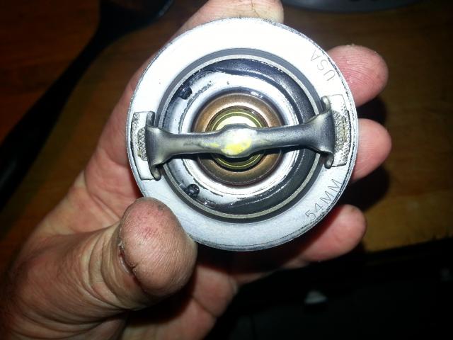

here is a pic of the bad thermostat that was in my HHR as you can see it appears that the rubber inner seal pulled back Name:  20131101_082409.jpg

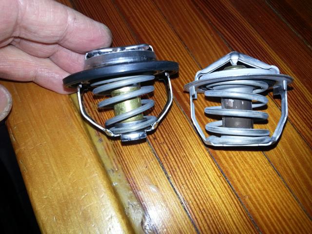

Also it appears that the new thermostat has been updated or at least it is coming from a different manufacturer
when tested side by side the new design tstat opens at 180 like the old one but for each degree it goes up there is much more room for coolant to flow through
