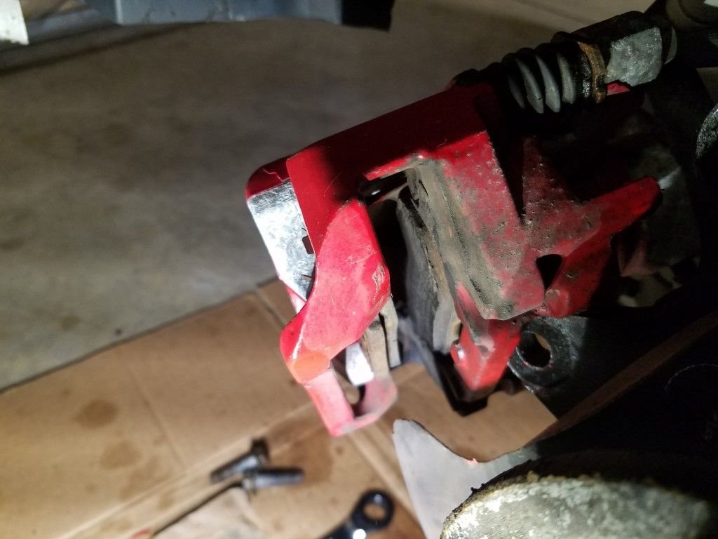

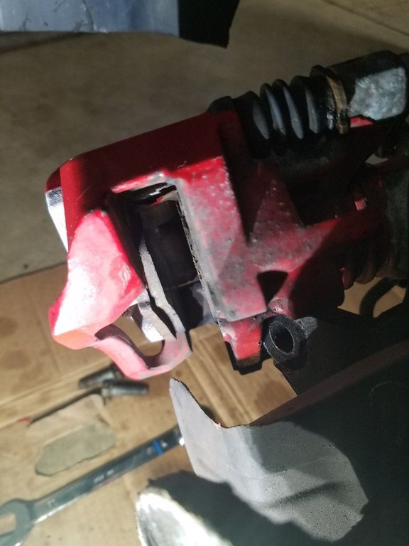

How about a right rear caliper not sliding/floating like it should and rubbing ****eyed on a slightly warped rotor causing my periodic "thumping" sound because of the slots and holes grabbing the inside pad. When I spun the wheel by hand, there was a pretty aggressive rotational, not constant, noise. I could see that noise might propagate through the car and maybe settle after a few stops. Thus why the sound would go away after a mile or so. Hub seems OK.
Thoughts?

Looks like paint has been rubbed off the caliper? Is the caliper contacting the disc?
