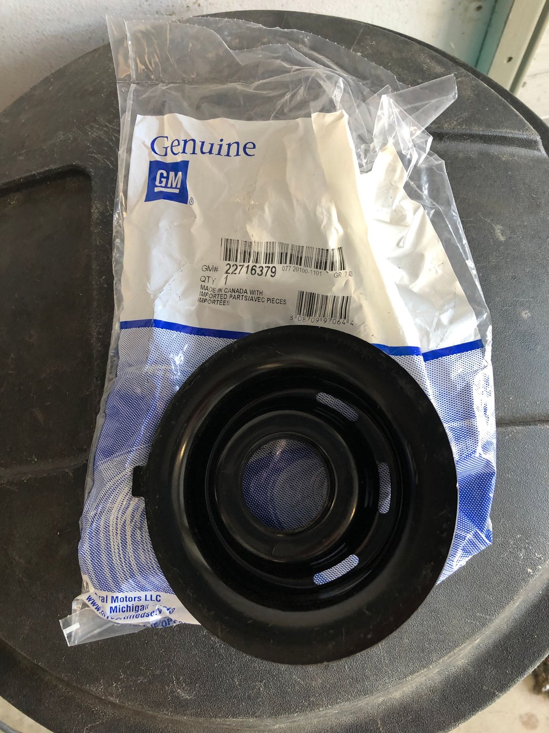

I'm replacing front struts on my SS (FE5 suspension). The upper strut hat (aka: upper spring seat, GM #22716379) has a tab on it. Assuming the strut is installed in the car, looking down from the top when standing next to the wheel, what orientation does the tab point to when installed (e.g., 12 o'clock, 9 o'clock, etc.)?
For those scoffers who might come back and say "why didn't you look before you took it apart?"...The spring busted so the orientation got messed up before I ever touched it and I believe the previous owner worked on the other side of the car, so I don't think the opposing side is correct either.

That tab points towards the body , opposite the bracket for the steering knuckle bracket. It should line up with the top end of the coil spring.

12 o'clock by my orientation. Whew, this is great to hear! I had to get them installed so that's how I assembled the struts yesterday, not yet having this feedback. Several search hits on Google indicated it might (but not 100% sure) be 12 o'clock (i.e., opposite steering knuckle bracket). So I took a guess that it might be 12 o'clock. In fact, the slant of the strut hat appeared to be aligned the best when I put it at 12 o'clock as well.

And for those in the rust belt, replace the upper spring plates
This plate is shiny and new, the tab that we’re talking about pointing to the left of the photo.
This is the crusty 9 year old piece , the rust scale caused rubbing and crunching while turning and binding the plastic bearing

Opposite of the steering knuckle bracket... Doesn't seem like 12 o'clock. We're talking about the bracket that is welded to the strut, right? So they would point towards the engine?
