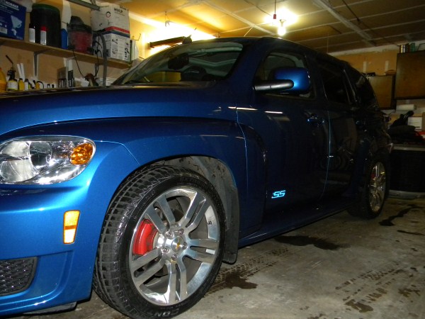

I had them mount a 255x40 and it fits but it was too wide on the wheel, side was way past square so I ordered 245x40 conti extreme contact DWS Wow I love them take a look next is the pedders
